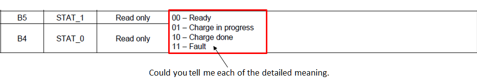

bq24251/Register STAT_1 FUNCTION
Customer is considering the TPS24251.
Please tell me about the FUNCTION in the data sheet P33.
want to know the concrete situation of 00,10,11.
Yusuke/Japan Disty
  • 11 - Fault - one of the faults listed in the fault register section has occurred
    10 - No fault and charging has terminated (i.e. V(BAT) has reached VBAT_REG and ICHRG < ITERM)
    01 -  Charging is currently in progress (i.e., V(BAT) < VBAT_REG - VRCH and ICHRG > ITERM)
    00 - Power is good and no faults but not charging
  • Hi Jeff,
    Thank you for your support.
    I understand that it is 00 state while in standby mode.
    Do I understand correctly?
    Yusuke/Japan Disty
