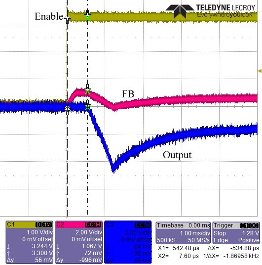

    Here's somecharts form average, bad and good startup:
    All prerequisites seem to be met:
    - Input voltage within range, filtered and stable
    - Reference voltage stable
    - Reference current below recommended value
    - Output filtered, current consumption low.
    Why can the enable not just fully enable the device and makes it do his job?
    Why does it go off without a proper reason?
    And if so, why can’t it try to come up to life again?
    Instead, it’s a mortally offended diva sitting in the corner and ignoring the world (sorry for the untechnical metaphor)…

  • Hopefully, the pictures will get through this time, otherwise, I have to rely on Katarina doing it in my place.
    Schematics:
    Good startup
    Bad startup caused from bias ( I can avoid that now...):
    Bad startup, even though no bias present. Reason unclear...

  • Sorry, I mixed the last 2 pictures:
    - The last image is the biased case. The red curve is the reference voltage. (just to make sure, it's stable: it is).
    - The 2nd image from below is the bad startup without a bias. The red curve here is the feedback.
    The interesting point about the bad startup without a bias, is that the output voltage is going significantly below -4V (like in the good case). It seems, like the regulator is going too far and noticing its fault, stops working completely (?)
    Phil

  • Hello Chris,
      If you take a look at the charts, you will notice, that the overshot is not a high frequency ringing, as you would expect from poor PCB layout. I checked this using a probe with short traces: It's rather a slow, "clean" overshot in 100µs time-domain.
