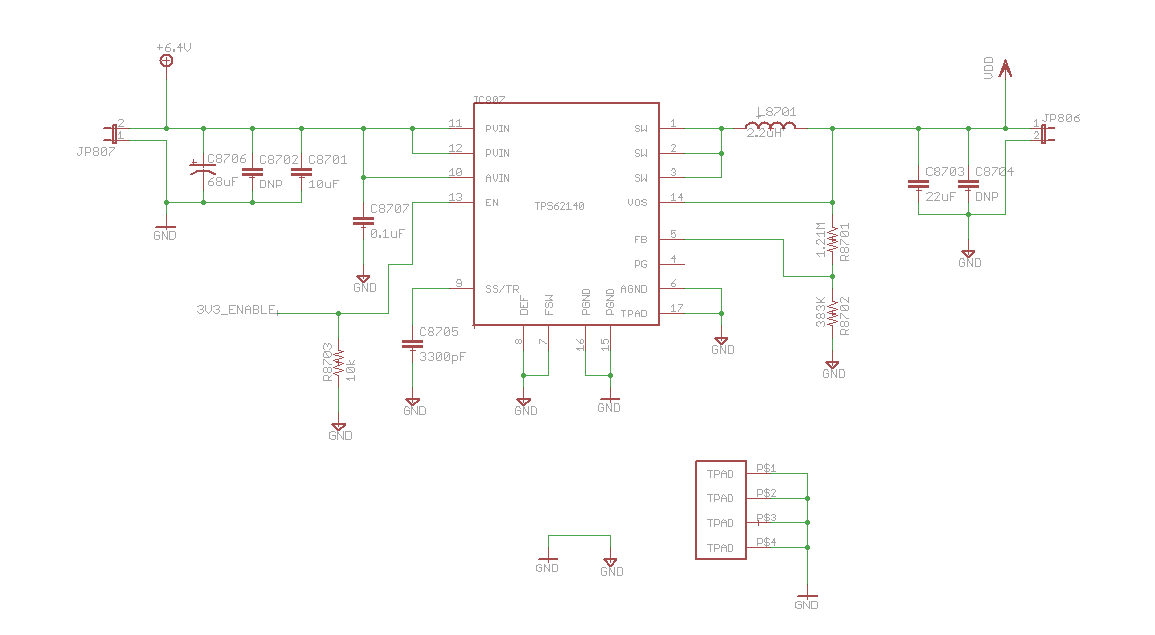

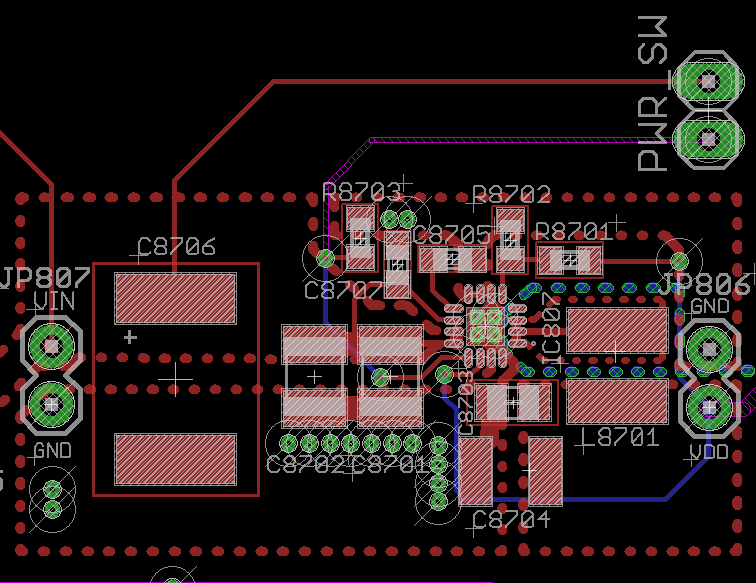

  • Hi Chris,
    Attached are the schematic and board for the regulator portion of our application. The switch is connected to pin 13 of the IC as you could see.
    I pretty much followed the EVM layout and schematic. Any recommendations?
    Thanks.
  • Thanks for posting. The layout is difficult to read since the planes are not showing as poured, but the concept looks like a copy of the EVM.
    It's not clear what the exact issue you see when you use the EN switch, but voltage excursions could be happening there as well due to the switch. You might try adding some debounce circuitry and see if it helps.
