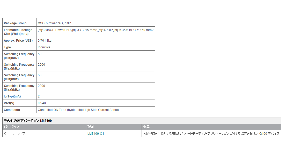

According the product brief, fSW max = 2,000kHz.
1) So, I would like to make sure how many switching cycles would be needed
for the proper iLED regulation under PWM dimming by external NMOS, theory-wise?

The datasheet defines 10,000 : 1 on its features and describes a design
example of fSW=500kHz.
I suppose the dimming range would be related to fSW.
1. So, I would like to know the highest capable fSW of LM3409-Q1.
