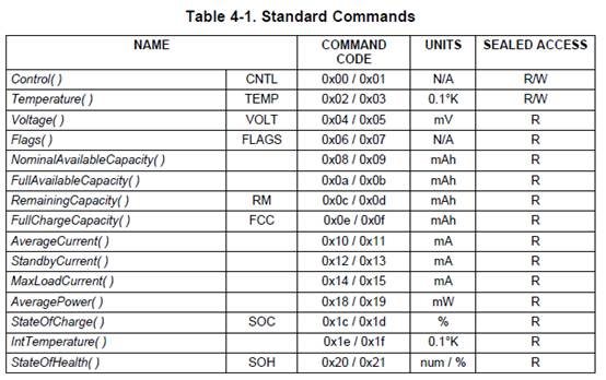

I have noted from the SLUUAP7 that there are two chapters: programming the configuration, Reading the gauge registers. But how can I write code to realize my function?
  1. Should my code only include two processes: to configure some parameters and read the registers for capacity?
  2. To configure the parameters, how to code it? I have noted that there are some commands. The commands are two bytes. What’s the c code of “I2CWriteWord()”?
  3. To read the registers for capacity, my code does not work right and the I2c2ValueGet1 is 0. What’s the problem?
thanks very much!
I2CMasterSlaveAddrSet(I2C2_BASE, 0x55, false);  //0101 0101  true-receive
I2CMasterDataPut(I2C2_BASE, 0x0c); //0c is the command code of RemainingCapacity()
I2CMasterControl(I2C2_BASE,I2C_MASTER_CMD_SINGLE_SEND);
I2CMasterSlaveAddrSet(I2C2_BASE, 0x55, true);
I2CMasterControl(I2C2_BASE,I2C_MASTER_CMD_BURST_RECEIVE_START);
 I2c2ValueGet1 = I2CMasterDataGet(I2C2_BASE);

  • Hey Dannel,
    To read the registers you need to first issue a write command, with the address of the register you want to read. This is the standard format to communicate with any I2C device, like our gauge.
    Please refer my code: github.com/.../gauge.c
    I have been able to read the register values, this means parameters like voltage, current, SOC etc.
    What I havent been able to verify is whether it is possible to update the parameters like design capacity, and terminate voltage, referred to as configuration of gauge. I have coded the steps in the config_gauge function, but it is not giving satisfactory results.
    To post doubts related to my code, use the github issues.
    Let me know if you made any progress
