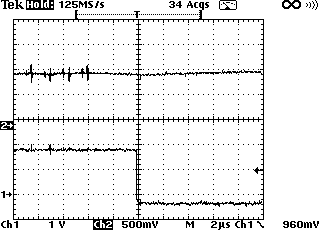

    Next I look at the output voltage rails themselves as you suggested. CVDD (output 1) appears fine though there is often a few spikes of noise a few microseconds before the power off event. These spikes dip to 0.86V and peak at 1.22V though I cannot be sure they are actually present on the rail - I suspect this noise is being inductively picked up by my scope probe. Here is a screen shot of my scope, the lower trace is the PowerGood output, the top trace is the CVDD rail.

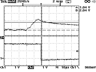

    VCC1V0 (output 2) is more interesting. This rises sharply about 20us before the power off event. Gets to over 2V and then starts dropping again. Here is the scope grab, this time the top trace is the VCC1V0 rail, note the different time base on this one:
    So, although the rail isn't going low, it is definitely going too high - will this also cause PowerGood to drop? What could cause this spurious rise in voltage? Could this damage the processor?

    In your 1.1V rail snapshot, I think the PG signal is de-asserted because Vout is below PG_OFF threshold. The PWM operation will continue, though.
    In your 1.0V rail snapshot, I believe the 2V overshoot triggered OV protection which shuts down the PWM, and as a result, the PG signal is de-asserted.

    The rise in voltage is probably caused by load transient. But normally the overshoot is controlled within a small range (tens of mV). So something is wrong on the board, possibly related to UCD9222's power stage. The 2V voltage may damage the processor. You'll need to check the processor's datasheet.

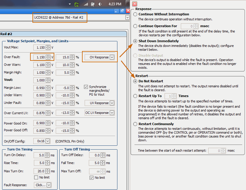

  • The documentation for the DSP EVM can be found from TI's webpage for the EVM (http://www.ti.com/tool/tmdsevm6657?keyMatch=c6657&tisearch=Search-EN-Everything). Scroll down to Technical Documents, then Third Party Documents (TI outsources the design of the DSP EVMs) and click on the Technical Documentation & Schematics for TMS320C6657 ....  This will take you to the eInfochips landing page containing the board documentation which includes the project file for the UCD9222.
    It doesn't appear that AVS (Adaptive Voltage Scaling) is used on the C6657 as both rails have been set to ignore the VID inputs so they should remain at a fixed level defined by Vout Command.  Unless they are using Vout Command to alter the voltage setpoint but I am not aware that they have implemented this method.
    The likely reason for the PowerGood falling is the OV Fault limit tripping for Rail #2, it is set to shutdown immediately.

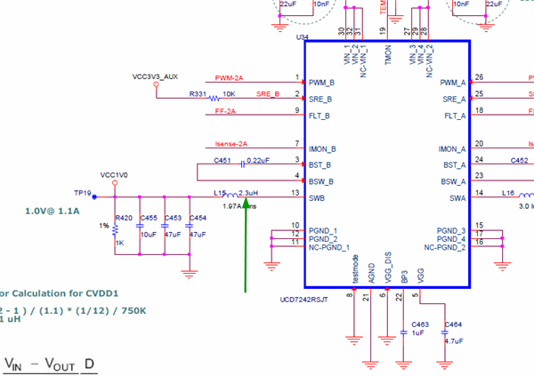

    Can you provide a scope shot of the SW node for Rail#2, this would be the driver side of L15 as shown below, during the time when the voltage is rising and during normal operation?  It will need to have enough detail to determine the pulse width of the PWM signal (4-6 pulses)

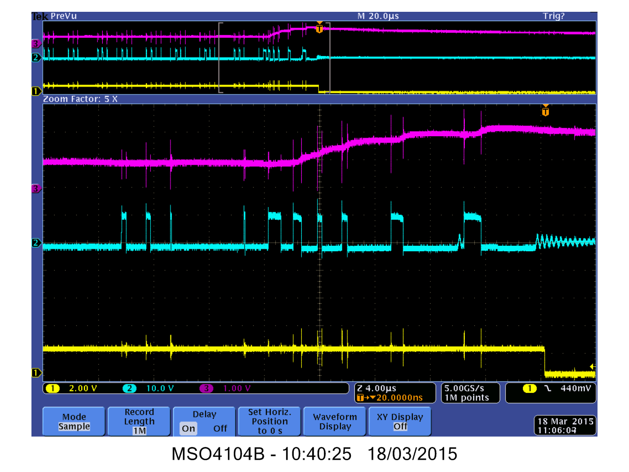

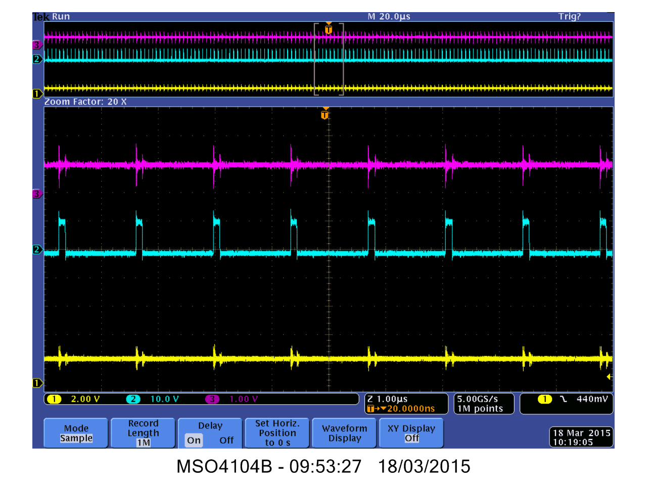

  • Thank you Zhiyuan and Brad for your continued help with this matter. I have commandeered a better oscilloscope and taken the data you requested. First the SWB pin in normal operation, after power up but before the power down event occurs. The yellow (bottom) trace is PowerGood, the magenta (top) trace is the VCC1V0 rail and the cyan (middle) trace is SWB pin. Note that my scope probe is acting like a nice antenna: the simple act of connecting it to the SWB pin puts spikes of noise on the other traces coincident with the PWM edges. This does not seem to bother the operation of the circuit though:
    Next is the same set up during the power down event triggered by a falling edge of the PowerGood signal:
    Does this offer any further clues?
