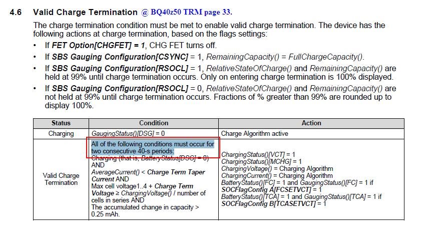

VCT condition check as below :
All of the following conditions must occur for two consecutive 40-s periods
(@4.6 of SLUUA43.pdf, page 33 / Version December 2013)
this is the last condition I've checked (AverageCurrent() < Charge Term Taper) .

  • Update:VCT condition  as below
  • It does not look like the pack rest period was long enough for the cells to stabilize. Was there a question in the second entry?

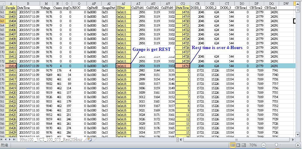

    "long enough for the cells to stabilize" is mean the pack status before charge?
    - The pack is REST before start charge. ( ITStat =0x0A11 @18414 )
    - Second entry is add VCT picture only for reference.
    Q1. Two consecutive 40-s periods is mean continue 80sec (40sec+40sec) ?
    Regard
    Robin
  • Yes, 80 seconds. I am not sure why it was defined that way.

    Let the pack rest longer. It has only rested for about 25 minutes in this log file and it typically takes 1 to 2 hours for the cells to rest enough for a Qmax update. You can zoom in on the voltage and see that it is still changing.
    Tom
  • Hi Tom
    Thanks, I am double check data log again. REST bit and REST time is OK .
    I am check VCT condition as below
    Step-1. Check VCT bit SET at sample 22148, [ ChgStat =0x0088]
    Step-2. and check voltage and Average-Current before sample 22148.
    Step-3. Check delay time meet 40+40 sec or NOT?
  • RB
    The REST flag was set at the beginning of the log file, but we are looking for it to be set at the end of the file after the discharge. Have you allowed the pack to rest longer to see whether the REST flag will set?
