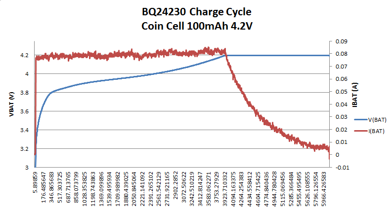

    Anyway, I have done a charge cycle with the bq24230EVM and a 100mAh LiPo battery. The charge current is set to around 80mA and the battery is able to reach full charge within  1 hour and 40 minutes.
