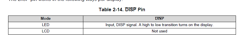

My question is about this 2 figures, I didn't understand how the DISP is not used and in the diagram is connected to REGG33?

Sorry that the documentation is not clear on this point.The LCD is activated all the time during operation except shutdown. Therefore the picture above is fundamentally wrong because it shows a display push button that won't do anything in LCD mode. You can leave that pin not connected, or pull up to 3.3V if you prefer.

No, I said you can leave the DISP (aka DSPL) pin open. The REG33 pin must have the capacitor.
