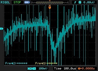

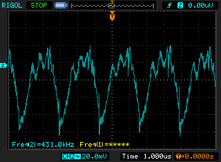

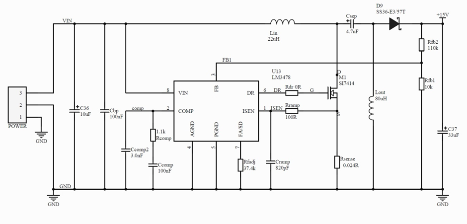

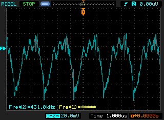

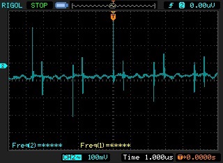

I have put together a Sepic power supply design based on WEBENCH results, and I am current having a problem with noisy output. I have included a couple of scope captures that show the problem. WEBENCH stated that peak-to-peak output ripple voltage = 173.375mV, this I though I could clean up with a LP filter, but my actual output is much greater that that. I would appreciate some input as to what I may have done wrong, and perhaps a solution.
