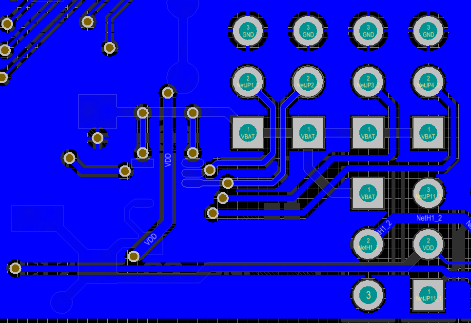

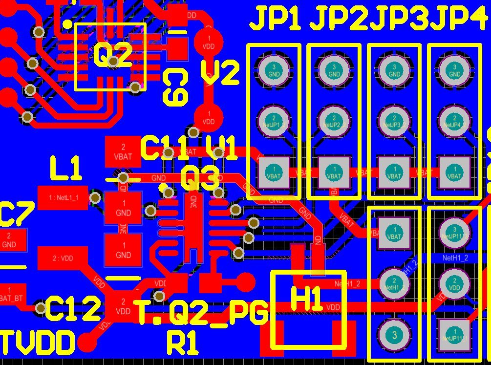

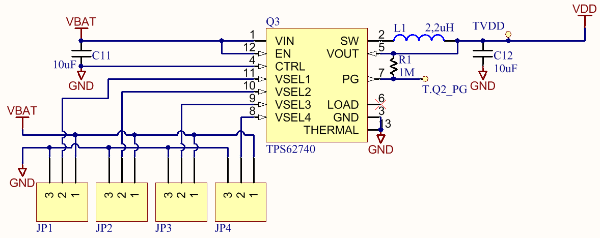

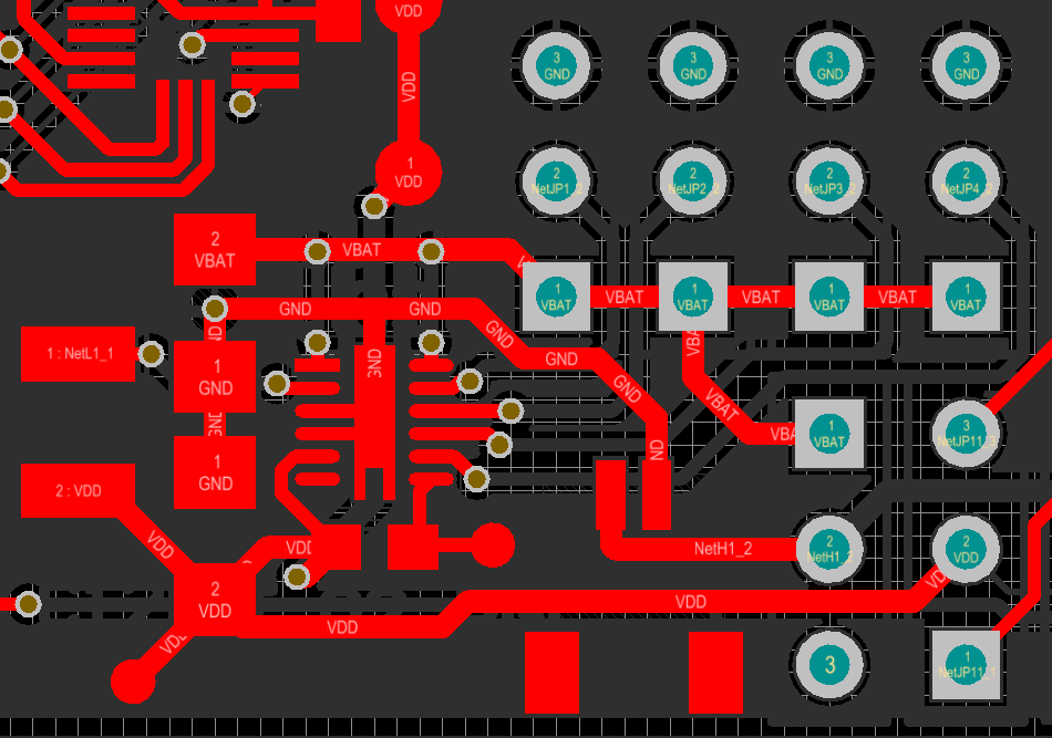

Hi everyone,
I am using a TPS62740 as a supply for an MSP430 and some peripherals.  The current consumption is at no time greater than 100mA so there should be no problem. Vin comes from a LiIon battery, so that should be alright, too. Vout is just as configured, and everything seems to be ok, yet it sometimes just dies without any visible reason.
So what kind of things should I look into to get this thing to work reliably?  Thanks a lot in advance,
