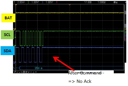

Hi  All
Now Our customer using  BQ27421 , but sometime  "No Ack"  after send command  factory shipping Test.
Customer  checking   Device ID all  MP set at Factory line.
But several set did not response ACK  ( No Ack)
【 Question 】
1)  Could you tell us this  situation ?   Why No Ack ??
  When this problem occurs, what kind of thing is considered?
    For Instance
      Device Busy ??   Signal Level is No good ??   Other Reason ??    Do you have anything??
Customer already made  more ten of thousands for MP.
This  " No ACK "issues appear for   several sets .
Regard
March Jasper  ( Sugimoto  / Japan Disty )
  • Hi March,
    Does your customer have any other chips connected to the bus lines. If yes, when the failure occurs can they disconnet the other chips on the line. How is their BIN pin connected to ground? Is it through a 10k resistor? How are the decoupling caps on bat and vdd placed? close to the chip? What values are used? can you share schematic and a layout?
