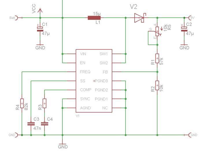

I’m building a Step Up Converter with the tps61175 device.
My circuit looks like this:
But I still have no idea about R3 and C4.
I Can’t find any helpful information in the Datasheet. Do you have fitting values for the R-C-Net?
The Network Specifications:
Input Voltage: 3,7-7,4V
Output Voltage: 9V(a little bit adjustable, to compensate tolerances)
Output current: up to 2A
Is there a minimum output current?
