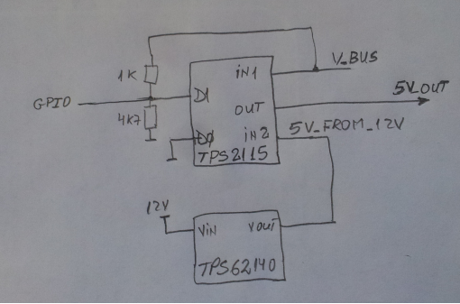

We use a TPS2115 to switch between two 5V supplies. One is usb V_BUS and another one is an 5V output generated from a 12V input using a TPS62140 (see attached drawing). When we disconnect V_BUS than the voltage on TPS2115 pin IN1 and OUT are as shown in the attached files.
What could be the issue?

  • Hi Dinesh,
    Unfortunately we will not be able to measure current waveform as I am not able to insert a resistor on the ground between the TPS2115 and the load.
    The load capacitance is as follows: on V_BUS is 10uF, on 5V_OUT is 860uF, on 5V_FROM_12V is 22uF.
    Which capacitance do you suggest to increase?

  • Hi Dinesh,
    We use the design in our own PCB - we checked the pinout one more time and they are correct.
    We discovered the issue was the GPIO was toggled from the microcontroller and was causing the switch to an input that didn't have voltage on it which in reverse was causing the microcontroller to reboot.
    What we try to design is:
    a) The switch is in manual mode with D0 being 0 all the time
    b) If there is voltage on IN1 we want the output connected to IN1 all the time (no matter IN1>IN2 or the other way around)
    c) If there is no voltage on IN1 the switch should connect the output to IN2
    d) We should be able to manually switch, using GPIO, to either IN1 or IN2 (when both of them have voltages on them).
    We achieved a), b) and c) with our design but the microcontroller is not able to drive low the D1 line.
    We use a level translator between the microcontroller and the switch D1 pin.
    Do you have any suggestion for achieving d) item ?
