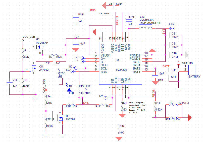

  • hi,
    tks for your reply. I followed your suggestion and use the bq24295. The circuit did output 5V. But this circuit doesn't charge the battery.  Below is our circuit. Can y
    you please help to see if there is anything wrong with this circuit? Our application is a standalone power bank without any MCU.
    Your quickest reply will be really appreciated.
    tks
  • Hello Sheng,
    Can you verify the voltage at VBUS when applying VCC_USB?
    I suspect Q4 and Q5 are backwards, the PMOS should be along the VBUS path and the NMOS should pull the PMOS low when VBUS is connected.
