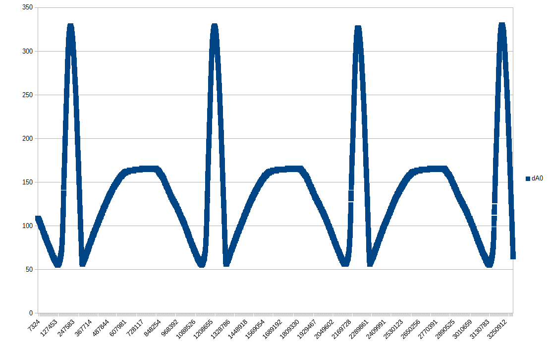

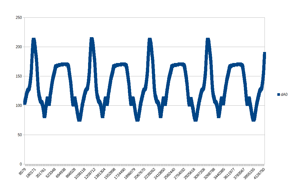

To make sense of the data, the data was plotted, with the results resembling the shape of a Viking Helmet. The 110VAC plot appears much 'cleaner' than the 240VAC plot, in that there is a short 'reversal' in the duty cycle appearing twice each cycle in the 240VAC plot.
Attached are 2 plots, one for 110VAC 50Hz 660 ohm load, one for 240VAC 50Hz 660 ohm load. The scale units are in the 10nS units of the logic analyzer capture.
The X axis is time from trigger, while the Y axis is the PWM pulse width (duty cycle) for the Q1 gate.
We don't understand the waveform we captured.

Attached are 2 plots, first is 110VAC 50Hz 660 ohm load, second is 240VAC 50Hz 660 ohm load. The scale units are in the 10nS units of the logic analyzer capture. Note 110VAC PWM excursion is to 3.5/5uS, while the 240VAC excursion is only 2.13/5uS.

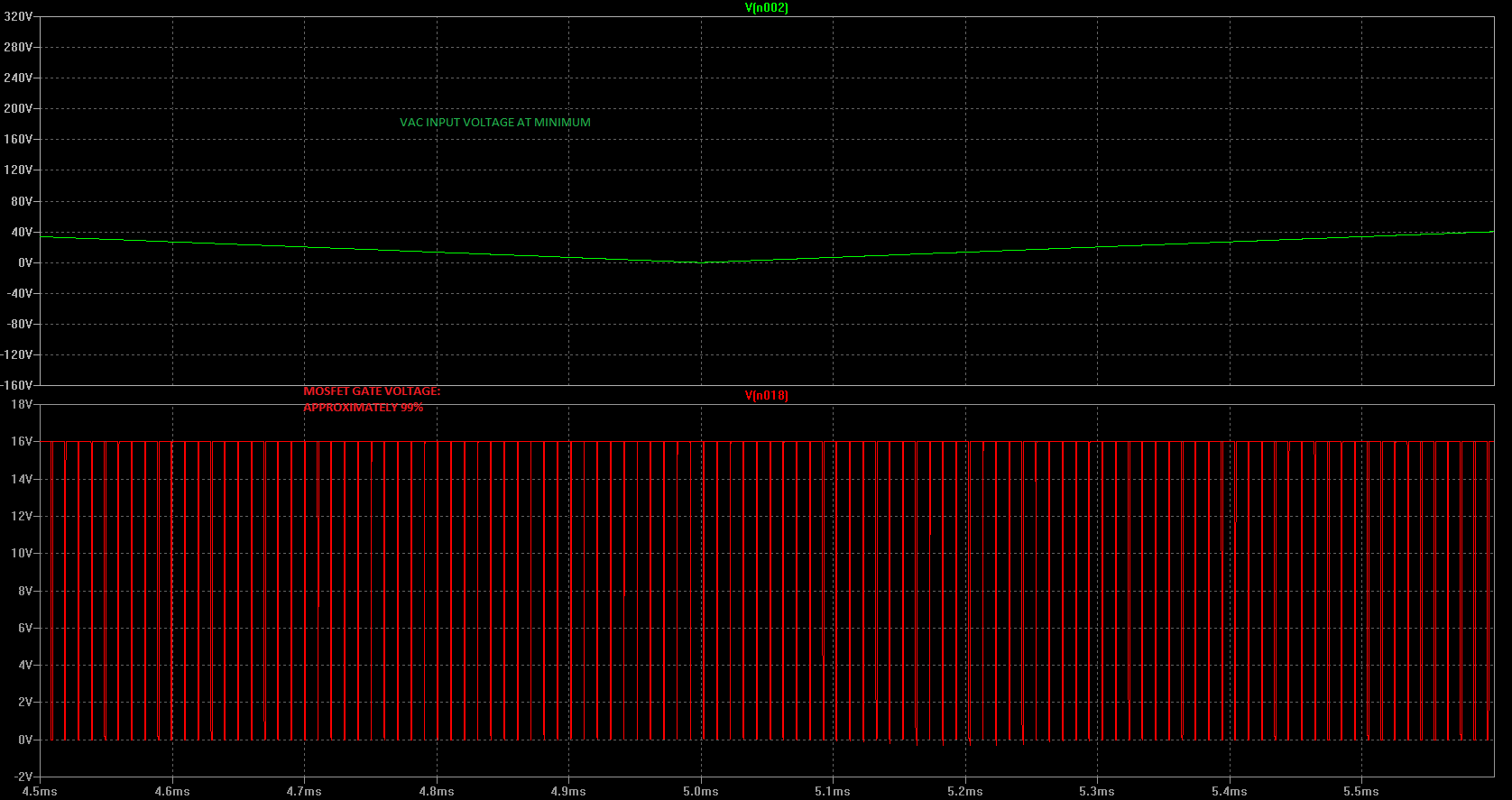

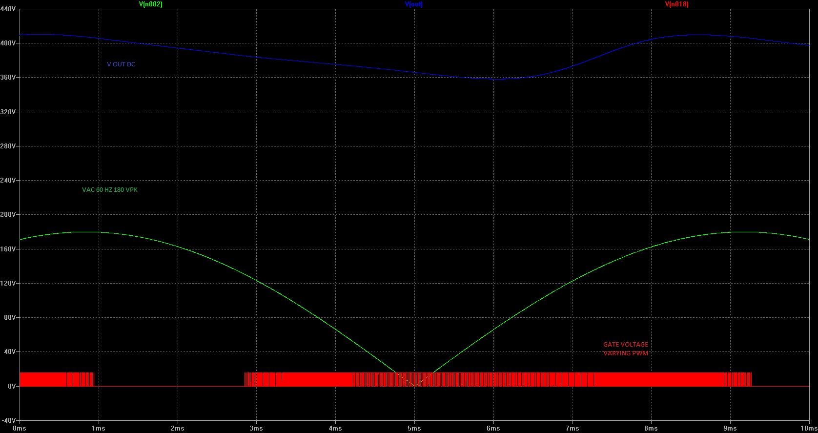

    I added some PFC simulation screenshots for your review:
    The top purple waveform is the DC output voltage. The green waveform is the rectified AC voltage that is input to the PFC boost circuit. The red waveform is the gate drive signal to the MOSFET with widely varying duty cycle. The duty cycle is maximum near the "cusps" of the AC input voltage and goes to zero after the peak. The zero duty cycle is due to the slow response of the PFC.
    Second waveform is a close up of the duty cycle and the input, rectified, AC voltage near the zero point or cusp.

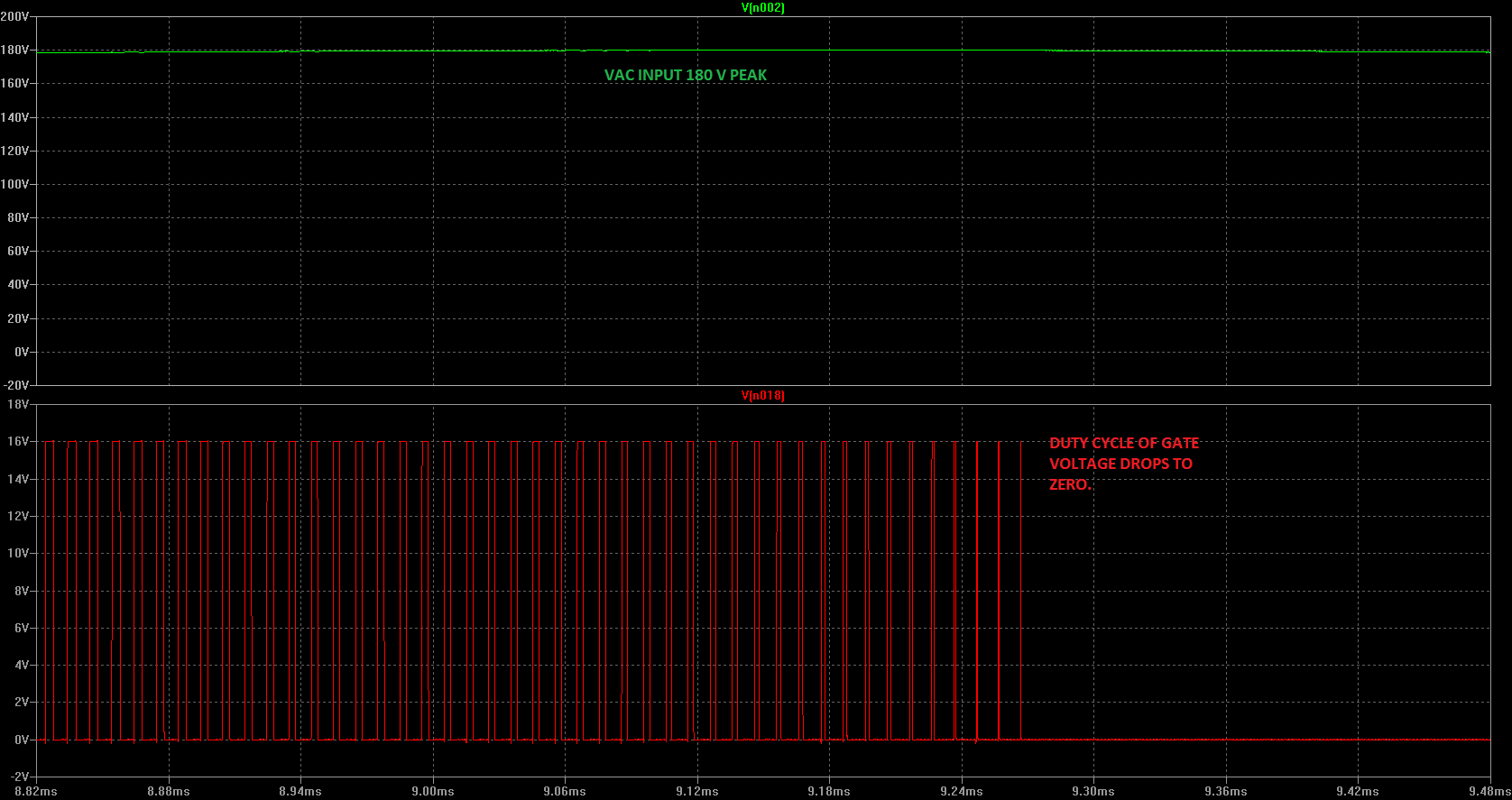

    The third waveform shows the duty cycle at peak VAC:
