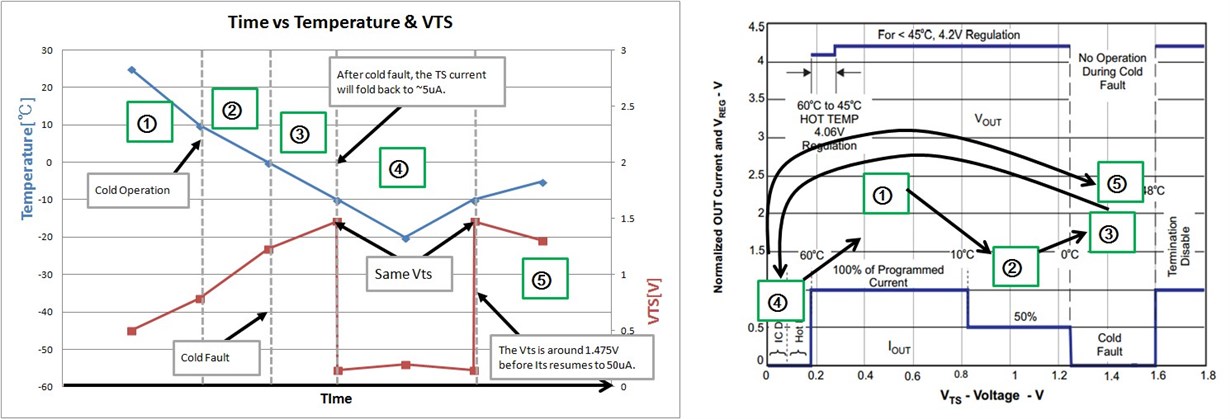

1. There is LDO Mode on figure 15.
   How is this mode?  There is no mention on the datasheet.
2. There is LDOHYS on figure 15.
   What is this?  There is no mention on the datasheet.

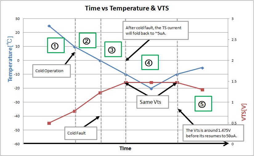

3. On P22. of datasheet there are such a following description.
"Once the thermistor reaches ≈–10°C the TS current folds back to keep a cold thermistor (between –10°C and –50°C) from placing the IC in the TTDM mode."
But on figure 15 the device becomes TTDM after Cold Fault.
Which is correct?
4. After folding back how much is VTS when ITS returns to 50uA ?
