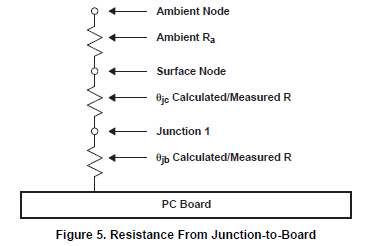

My Customer said , Ambient Ra is higher than Theta Jc Calculated/Measured R.
It is wriiten by application note 'SPRA953' .
