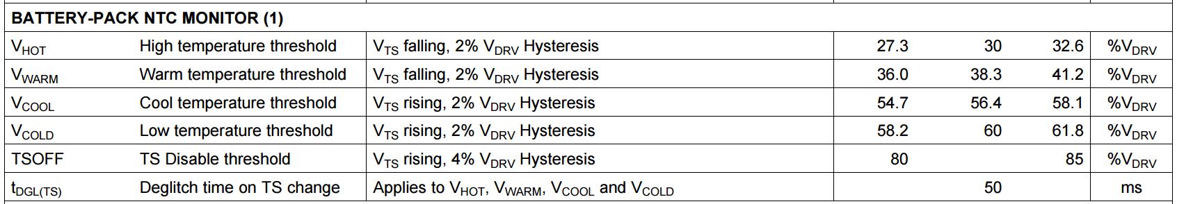

Let me ask about NTC monitor threshold of bq24262.

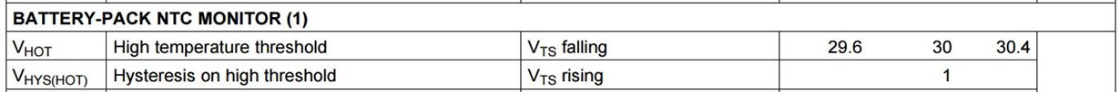

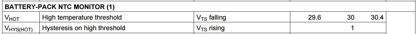

The other device like bq24250 has hysteresis as separated parameter, but bq24262 looks include hysteresis in each threshold. Then,
  • Are these value of 2% and 4% typical value?
  • Can we take hysteresis from each threshold if we want to know threshold without hysteresis? For example, will the VHOT without hysteresis be 25.3%(min), 28.0%(typ) and 30.6%(max)?
