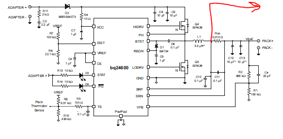

Hey team,
Can the BQ24600 be used by attaching the system load from the left side of Rsense on the picture attached?
Evan
  •  Picture did not attach. here you go. Please inquire asap.
    Evan
  • Evan,
    This is not recommended since there is no way to monitor the total output current. If a short happens on the system load, it could burn out the external MOSFETs. It's not mentioned in the datasheet, but the charging current is limited to 3A when VBAT < 3V. This is to protect the body diode of the low side MOSFET so that it doesn't experience high current.
    If you need this functionality, I would recommend a charger that supports narrow voltage DC (NVDC) architecture. What is the customer's battery voltage? What is the desired charging current? I would recommend looking at the bq24133 (1-3 cells, 2.5A charging current) or the bq2417x (1-3 cells, 4A charging current).
