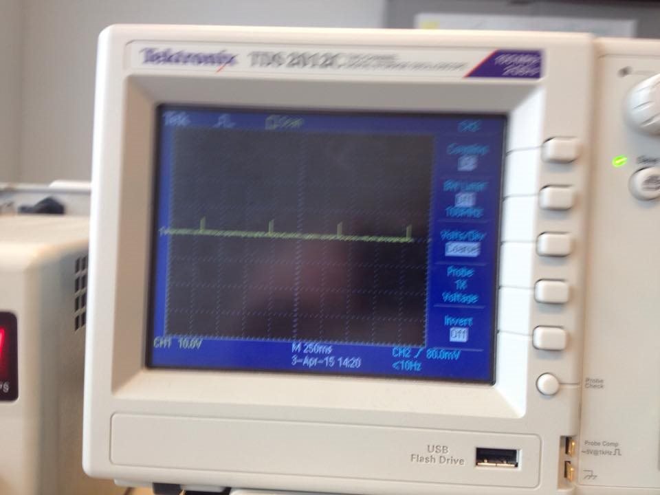

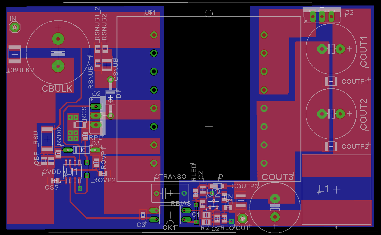

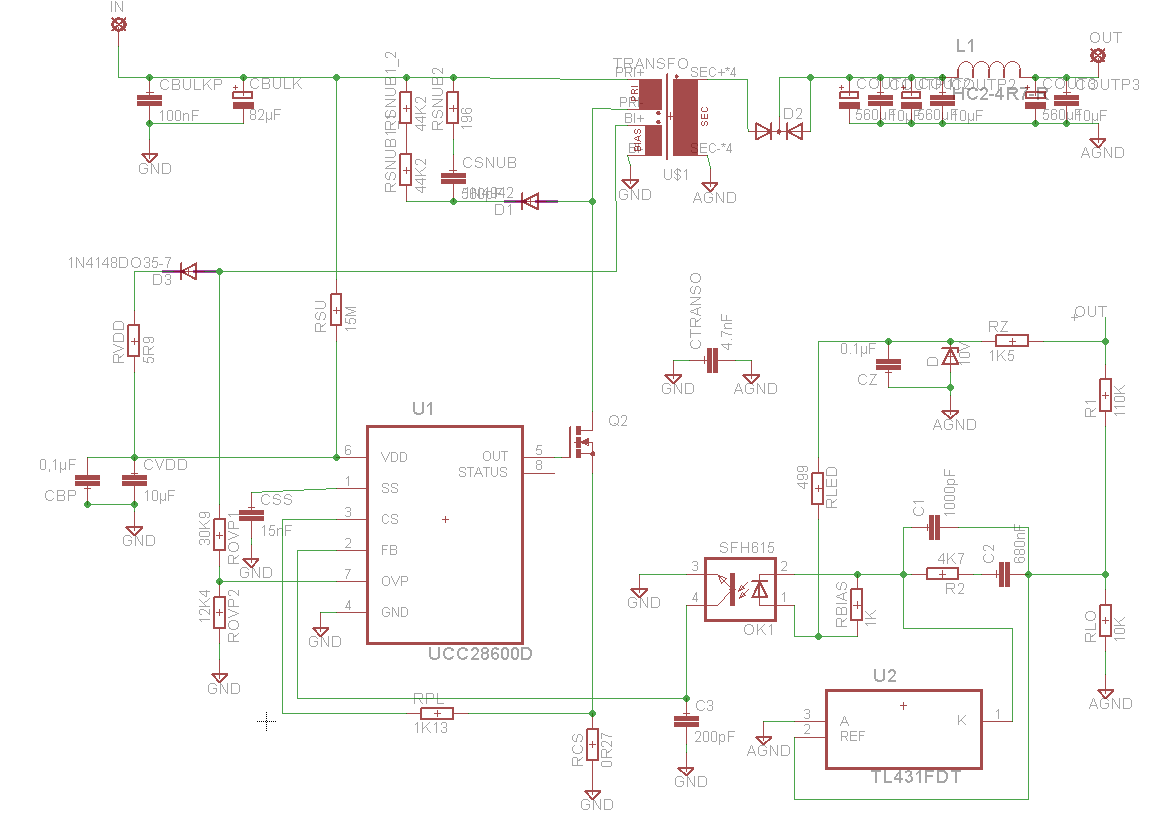

I'm a student Industrial engineering from Belgium and i'm trying to build a power supply with the UCC28600. The company i'm doing this for already has a 350V DC supply, so I don't need the AC/DC conversion. From this 350V I have to maken something between 30 and 40V at 100W. My available lab equipement only supplies me 150V, so I recalculated everything for that input and only the Rsu made a critical change so I raplaced it. In the 2 pictures below you can find my PCB layout and my schematic

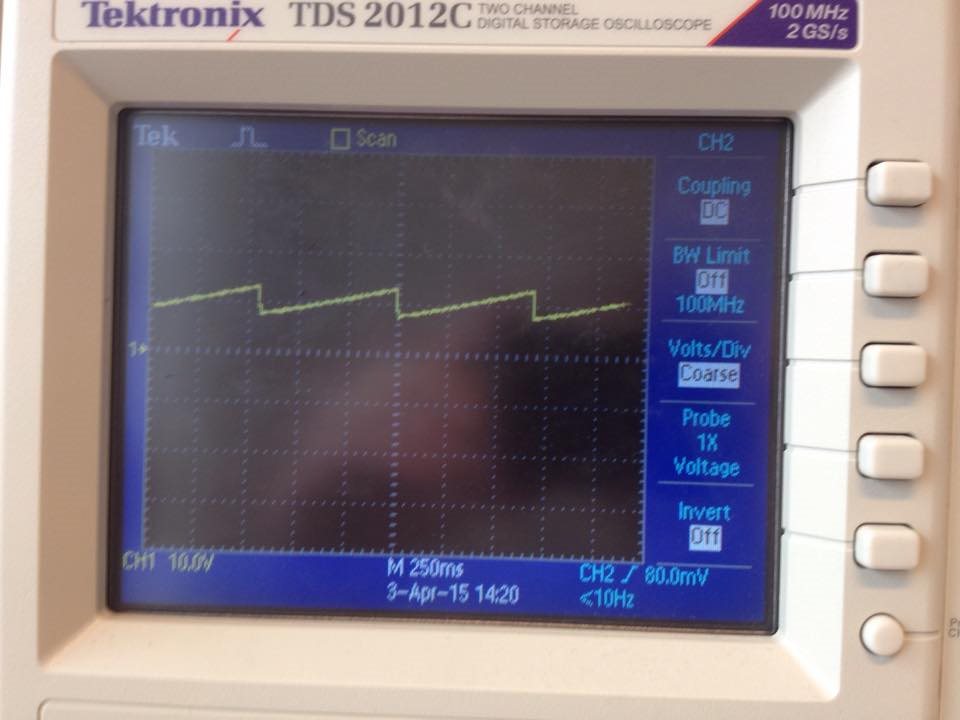

The problem I'm facing is that for some reason when passing the startup threshhold (13V) at the VDD pin, it immediatly goes back to the switch off threshhold (9V). Nothing else happens exept a smile spike at the feedback pin. (see pictures below)
VDD:
feedback:
Is there ayone who can help me? Please do, cause I've been searching for weeks.
