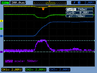

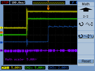

    Following pictures (below left and right) show waveform for VBUS (CH1, +12V), VBUS_PIN(CH2, +12V through 0.47ohm), SYS (CH3).
    Left picture is problem board (SN02),the SYS output only settle on 2V. RIght picture is a good board (SN01), SYS output can reach to 4V. The purple color is "CH1-CH2", which has division of 5V, divide by 0.47, should give current waveform, but for some reason, it seems no current change is recorded here (?).
    Above picture show BAT pin through a 0.47ohm resistor, again, CH1 is 3.7V battery, CH2 is 3.7V through a 0.47ohm resistir (BAT pin),  SYS output CH3 (o.k.), battery peak current is about 740mV/0.47ohm = 1.5A.

  • Hi Roger,
    Did you mean, after you swapped IC, problem board still showed Vsys=2V, but the other 3 boards are ok? If so, we will need to debug from board. There might be leakage path in the board.
    if not, one experiment you can try is, turn on/off Q4 and watch SYS voltage change. Can you capture waveform of good and bad boards? Thanks.
