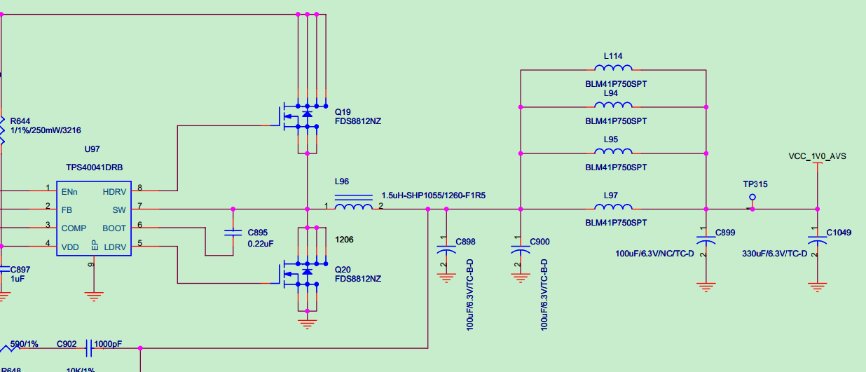

It is a good practise to place a ferrite bead in DC/DC's output for high speed CPU or DSP core power?
HI,TIer.
Right now, we are using DM8168 to develop our audio/video recorder.
However,the referrence design by Udworks version 03A is that: place three/four ferrite bead parallel in DC/DC's output.

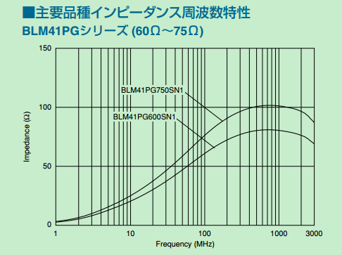

However, according to the TI's power measure doc, we should measure the power noise up to 250MHz frequency.
So,when the frequency goes up to 200MHZ,the ferrite bead will be like a resistor,and the output will be like a R-C charging circuit,then can not charge ouput capacitor quickly,then the transient response will not be good.
And last,I think, when in high speed CPU/DSP core power, the ferrite bead should NOT be placed in the output.Am I right?
Expecting for any reply.
