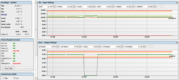

I have some trouble with the input voltage to the UCD9248 with a UCD7242 driver. When I turn off the input power supply to the UCD9248, the input voltage slowly drops (due to a supercap). See picture attached.
The VinON property has a value of 8V. The VinOFF property in the Fusion Digital Power supply software has a value of 5.5V.  This means that the UCD9248 (with the UCD7242 driver) will stop converting power. So when the input voltage drops to 5.5V the power conversion stops, as expected. So far so good.
But when the UCD9248 stops power conversion at 5.5V, the input voltage rises a bit to approx. 6.5V, due to stopping the power conversion (no load). The input power supply is still off.
When I turn on the input power supply, at this 6.5V the UCD9248 does not start up! See picture, the output voltage is still off. I have to wait until the 6.5V drops again to <5.5V, then turn on the power supply and it works fine.
This means that the hysteresis does not work properly. Is there something I can do?

  • Hi Zhiyuan,
    Thank you for your reply.
    In the figure you can see that when the Vout is shutdown due to VinOFF setting of 5.5V, the input supply is jumping up about ~0.7V. This is because the load is switched off and the cable losses are not there anymore.
    You can simulate the cable losses by adding a low resistance resistor (~0.25 ohm, depending upon EVM load) between the lab-power-supply and the EVM. When the EVM then switches of the load, the supply will also jump a little bit.
    When I don't have the 'jump' in the Vin supply ( no cable losses), then it works also fine here. But you always have some cable losses in your end application.
    The VIN_UNDER_VOLTAGE_FAULT condition has the same issue.
    For now I'm doing the assumption that:
    The UCD9248 seems to 'forget' that there was a 'Low Vin' condition, due to the probably fast jump in the Vin, when switching off the load.
    Can you confirm this and have a possible solution? Or do you see the same problem with the above EVM setup, with the added low resistance resistor in the power supply?
    Thanks in advance,
    Ben

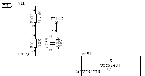

    2) "If Vin jumps back too fast it may be an issue. In the case of cable resistance, you can try increasing input capacitance to slow down the Vin jump."
    As seen in the schematic (below) of the UCD9248, it has already an RC filter to the input pin of the UCD9248. I did increase the 100nF to 3uF but the problem still persists....
    You could quite easy reproduce the problem with the lab-power-supply with an added low-resistance resistor (~0.25mOhm) in the power cable to the EVM.
    Of course the EVM should have some load to switch off. Did you see the same effect?
    I still think the UCD9248 seems to 'forget' that there was a LowVin and if then the VinON (8V) is reached, as seen in the graph earlier, the output does not switch on. But there is no reason not to do this.

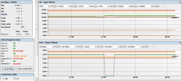

  • Hi Zhiyuan,
    I did the settings as you suggested.
    VIN_UNDER_VOLTAGE_FAULT = 6.5V
    VinOFF = 5.5V
    VinON = 10V
    In the graph below you can see that this does not work.
    I checked the setting for the "restart continuously", as seen below:
    Are there any other possibilities?
    Thanks in advance,
    Kind regards,
    Ben

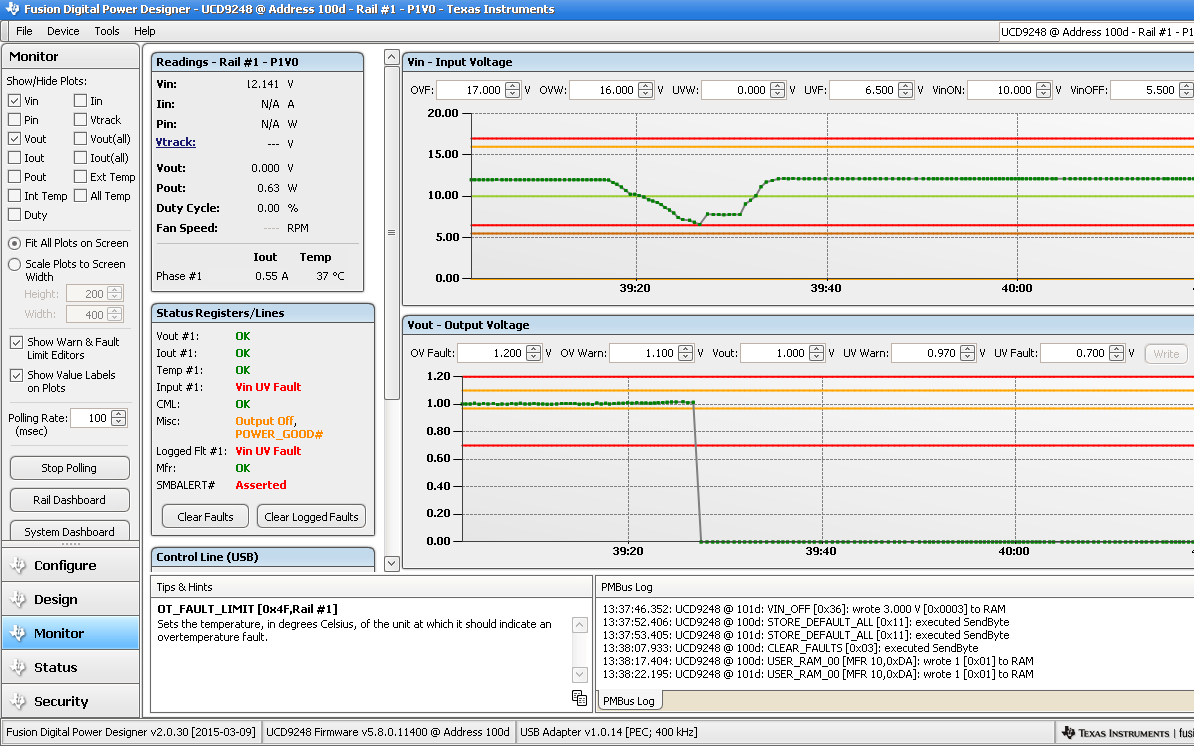

  • Hi Ben,
    I put 10 ohm on my EVM Vin port and cannot replicate the problem. Both Vin_Off and Vin_UV work fine.
    Vin_Off:
    Vin_UV:
    Is there any turn-on dependency that may prevent the rail from turning on? I can take a look at your project file.
    Zhiyuan
