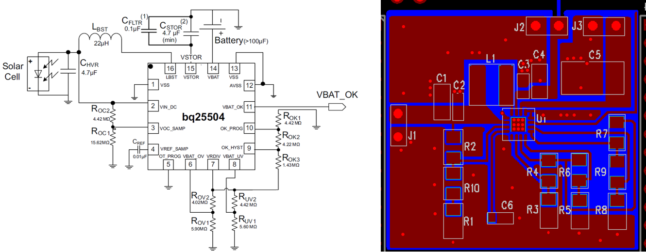

Based on the solar application circuit, I have finished the design and layout. I was wondering if it would be possible to get some comments on the layout. Thanks.
R1+R10 = ROC1, R2 = ROC2, R3 =ROV1, R4=ROV2, R5=RUV1, R6=RUV2, R7=ROK1, R9=ROK2, R8=ROK3, C6=CREF. rest are the output and input capacitors.
