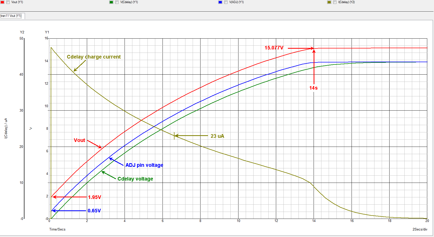

I am looking at Figure 23 from SNVS775J –MARCH 2000–REVISED MARCH 2013, for a slow turn-on circuit employing a LM317L-N. I wanted to know if there are any equations and graphs for this circuit available from TI, to find out the approximate time as needed for the application in mind.

  • Sorry, no equations, no tools, no graphs.
    Circuit is pretty straight-forward.
       Resistors R1 (240) and R2 (2.7k) set the final Vout.
       Diode (1N4002) discharges C1 at power-down
       Transitor PNP (2N2905) buffers the voltage on the delay capacitor back to the ADJ pin, and provides a current path to charge the delay capacitor.
    At t=0:
      Vin is applied ;
      the voltage on the delay capacitor= 0V;
      the voltage across R1= Vref=1.25V
       the current through R1= Vref/R1= 1.25V/240= 5.2 milli-amp
      the voltage across R2= Vbe+Vcap= 0.65V+0.0V= 0.65V
       the current through R2= 0.65V/2.7k= 241 micro-amps
        the current through R3= 0.65V/51k= 13 micro-amps
        the current through 2N2905 emitter= 0.0052-0.000241-0.000013= 4.95milli-amp
        the current through 2N2905 base= 4.95milli-amp/150 = 33 micro-amps (note the current gain here is a best guess)
        the voltage at Vout= Vref+Vbe+Vcap = 1.25V+0.65V+0.0V= 1.90V
    The final voltage across the capacitor will be the same as the final voltage across R2 = ((Vref/R1)xR2)= ((1.25V/240)x2.7k)= 14.06V
    But at some point the voltage on the cap will be less than a Vbe away from the voltage across R2 and the charge current into the cap will start to drop off to zero.
    To keep it simple I will just presume that the circuit will charge Cdelay in straight line (it's not) from 0V to 14.06V-Vbe= 13.41V
    The average charge rate will be about 50% of the sum of the peak base current (33 micro-amps) and the peak current through R3 (13 micro-amps) = 46 micro-amps/2= 23 micro-amps
        time = ((C / I) x dV) = ((25 uF / 23 uA) x 13.41V = 14.6s
    Simulation shows that's pretty close ...
