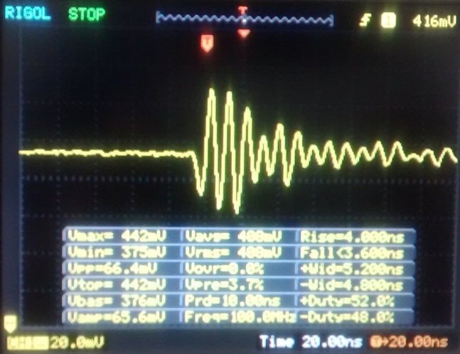

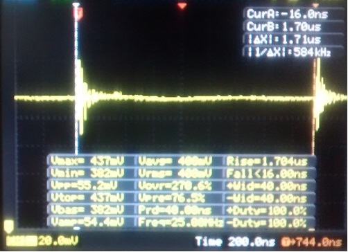

We are getting quite a high noise generated every 1.7 us i.e. @ switching frequency.
The noise is around 100Mhz in frequency and around 660mV pp.
We have tested it using TPS54231 TPS54331 and TPS54332 Same Problem.
Please suggest.
I am attaching Waveforms and Circuit.
( The probe is kept at 10X to properly visualize)
(The output desired voltage is 4.3V)

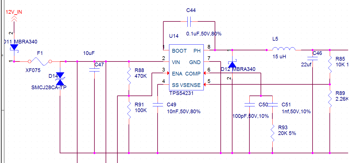

Circuit:
