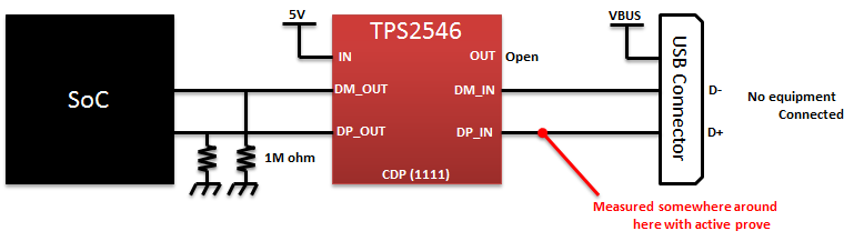

Hi, my customer has reported me that short pulse can be seen on DP_IN line after approx.1.2ms from enabling TPS2546. Please see the set up as  below.

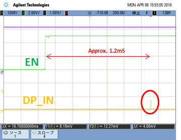

On this test bench, customer toggles EN pin to switch device mode betwee enable and disable. What customer has observed here is, after almost 1ms from toggling EN to high, short pulse with 0.8V can be seen on DP_IN line. See waveform below. (5V supply voltage for IN pin is on during this.)
When I checked TPS2546EVM with my windows PC, the wavefrorm is not like this. Have you seen this before? It's greatly appreciated, if you can let me know the reason why this happen. Also can you reproduce the waveform at your side?
