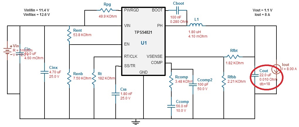

Dear Sir
I use TI Webench to simulate 12Vin to 1.1Vout / 8A
But the result use 18pcs of 22uF capacitor ,Is it correct ??? I think it's too much
