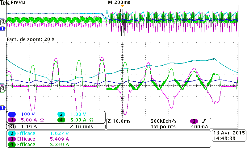

I'm using the UCC28070 PFC controller  2KW  400V.
When the output power exceed 1KW the PFC converter stops. I don't understand what it stops because I m not on current peak limit condition and  It doesn't exeed the over voltage protection condition.
I trayed to change the IMO resistors, current loop and voltage components... and it doesn't work yet.
I would like to know if you have some ideas about this topic.
Thank you for your help.
  • Please attach a schematic with some waveforms.
    It would also be helpful to know what the test condition were .

    I have the same problem.
    When the output power  exceeds 1KW, The output voltage dropes Sharply.
    All protections seems to be OK.
    I tried to change RIMO, VAO filter and CAOA compensation filter.. But there is no change.
    Below signals when the output power exceeds :( see attached file)
    - Green : Current inductance
    - blue :Output voltage
    - Sky bleu : VAO voltage
    - Purple : Input current
    I don't understand why it stops.
    Do you have any ideas ?
