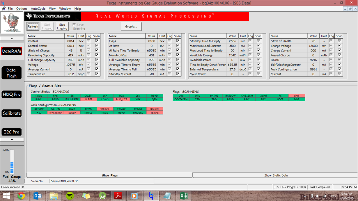

I am trying to connect a bq34z100 EVM with a EVM 2300 in Multi-cell mode with 4 cells. On connection to the PC and the bq evaluation software, the software does not display the complete value of the battery (4 cells in series). If I use a single cell to connect to the EVM, it shows the data correctly. On trying to write the registers, the data is not updating even after number of cells was changed to 4 (for multi-cell mode). Also I’d like to know how to configure the LEDs so as to indicate the SOC. I tried in the LED comm register but it didn’t reflect in the register.
  • You will need to take these steps to configure the gauge for 4S and they need to need to be done before you enable IT. If you have enabled IT already, then you will need to reload the default senc file to disable IT first.
    • Set to the # of Series Cells parameter to 4.
    • Set the VOLTSEL bit in the Pack Cfg A register.
    • Calibrate the voltage. .
    The gauge should show the proper pack voltage now and you can configure other parameters. Enable IT after everything has been setup.

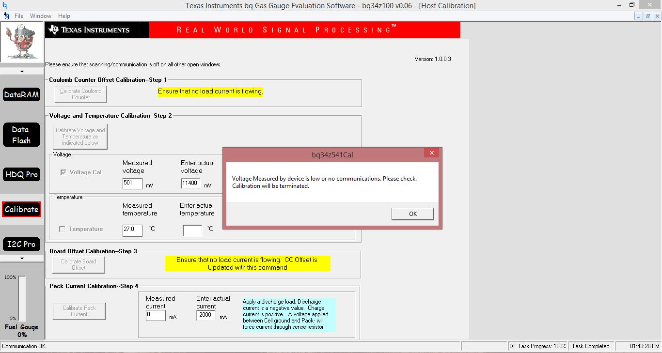

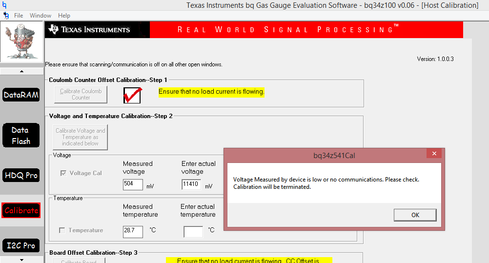

  • Thomas,
    I was able to complete steps 1&2. When I clicked on the Calibrate Voltage button, by setting the measured voltage, I got an error pop-up stating that "Voltage Measured by device is low or no communications. Please Check. Calibration will be terminated."
    I am very new to BQ34z100 and have no idea how to go about solving this issue. Please see the error message below. I would also like to make a correction, I have only 3 cells in series, not 4 as mentioned earlier. Sorry for the wrong information. Can you also please guide me with steps, on how the process of reloading the .senc file is done?

  • Hi Tom,
    I followed all the steps that you mentioned, but I am still getting the same error. Just to check I'm entering the correct values, on selecting the VOLTSEL bit, the entry into the Pack Configuration Register has to be 1161, right? I have 3 cells in series and have entered the same in the Num of Cells. When I enter the actual value in the Calibration screen, I get the error shown below.
    Please let me know if I am doing something wrong.
    Badri
  • The VOLTSEL bit is Bit 11. It should be 0961.
  • Thanks for your reply Tom. I have corrected the register value to 0961 and the I was able to calibrate the voltage. However, I have a question about the LED register :

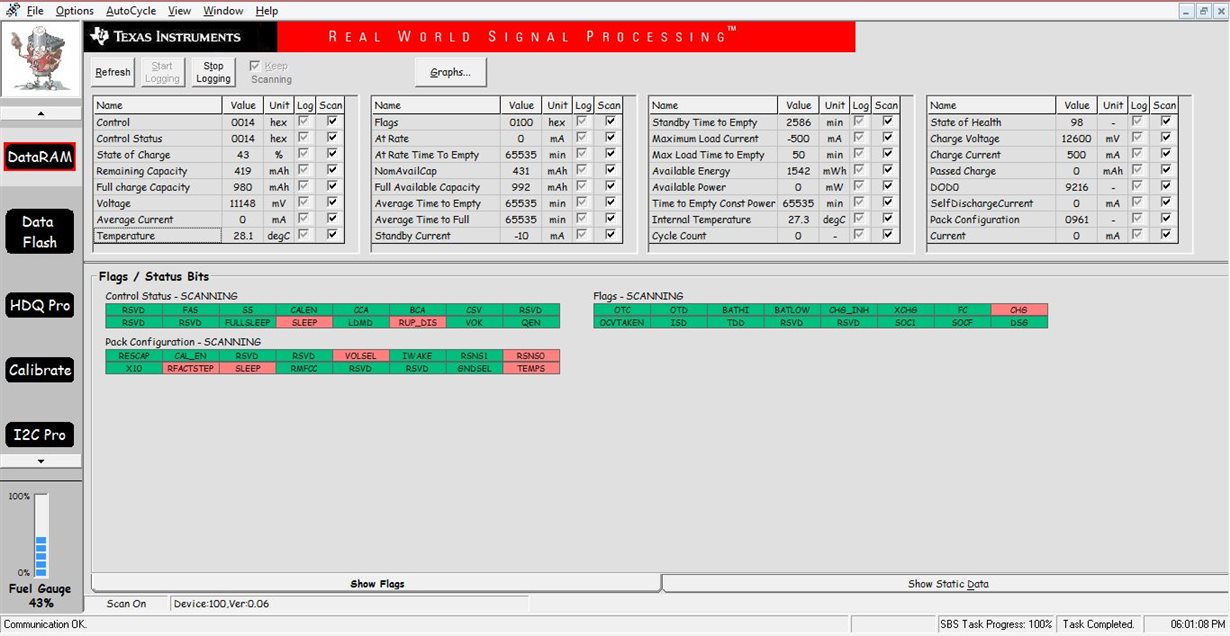

    I was recording the data from my battery (3 cells in Series) but I was not able to see or record the current data. I am attaching screenshots and the data log for your reference. I had connected a headlamp to the battery in series with a switch so that I can record how it behaves in the presence and absence of load, but only the voltage changed. One more concern is that the SOC shows 43% throughout the whole recording time and also all 4 LEDs are lit up. Can you please throw some light on why I'm not able to record the current data and also the SOC and LEDs ?
      Headlamp test.xlsx
    Badri
  • Badri,
    Your log data clearly shows that you have a load based on voltage and temperature changes, but there is no current and passed charge logged. This would indicate that either the device or sense resistor network is broken. I would try applying 50mV across the SRN/SRP pins on the device to see if it registers any current.
