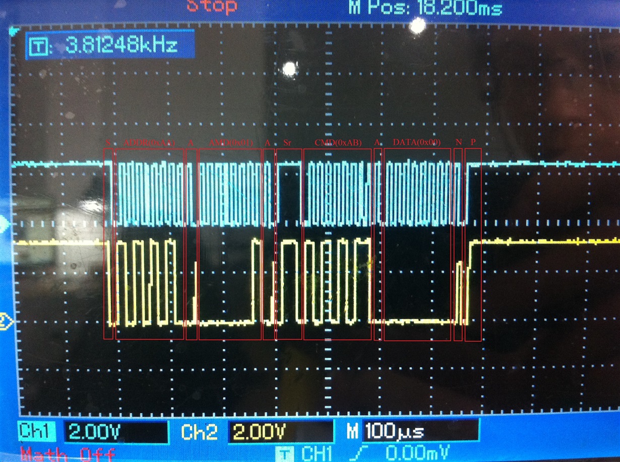

hello everyone ,
When I use STM32F103 chip communicate with Bq34z110 chip through i2c , it comes a strange phenomenon: I get different datas from address 0x00 and 0x01 , and these data is changeing every few minutes,and the data from address 0x00 is always as same as the data from  address 0x01. I follow the step in page 28 of slusb55b.pdf, here is the waveform about i2c communication . Is there something wrong with my i2c communication ?
  • Stefan,
    Your process looks correct. Could you have some other polling for the bq34z110 on occurring on the bus? Data from the Control register can change as the firmware is running. The firmware uses this register in addition to it being the port for the Control Subcommands. Here is a document that covers communications to the device and it has an example of reading the ChemID. Have you tried using the EV2300 and bqEVSW to read the ChemID?
    Tom
    1641.bq34z100 DF access.pdf
  • Tom,
    I have used EV2300, and it's working,and I have read the document you provided . In the read mode, after send CMD(0xAB) there's no ack response , do you know why ?
  • There should be an ACK after the AB address and no ACK after the last data byte returned. I see this in the waveforms that you sent. Does the correct data get returned when using the EV2300? (It was not clear which case was not working in the previous response.)

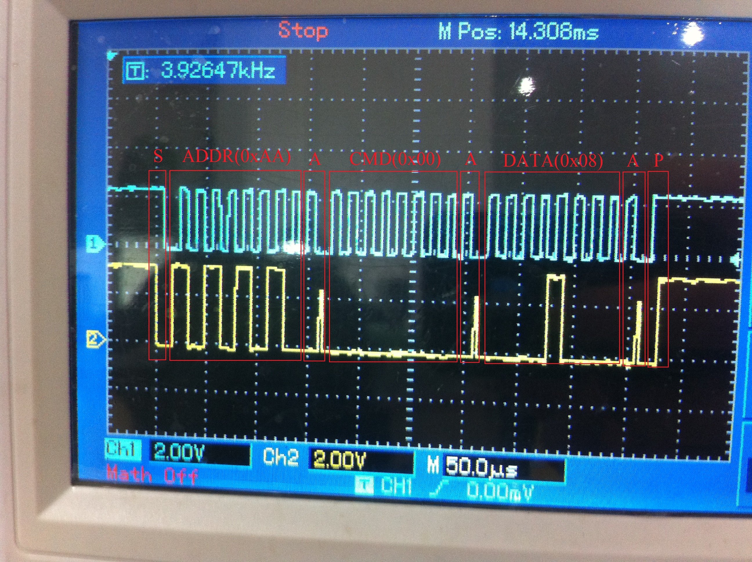

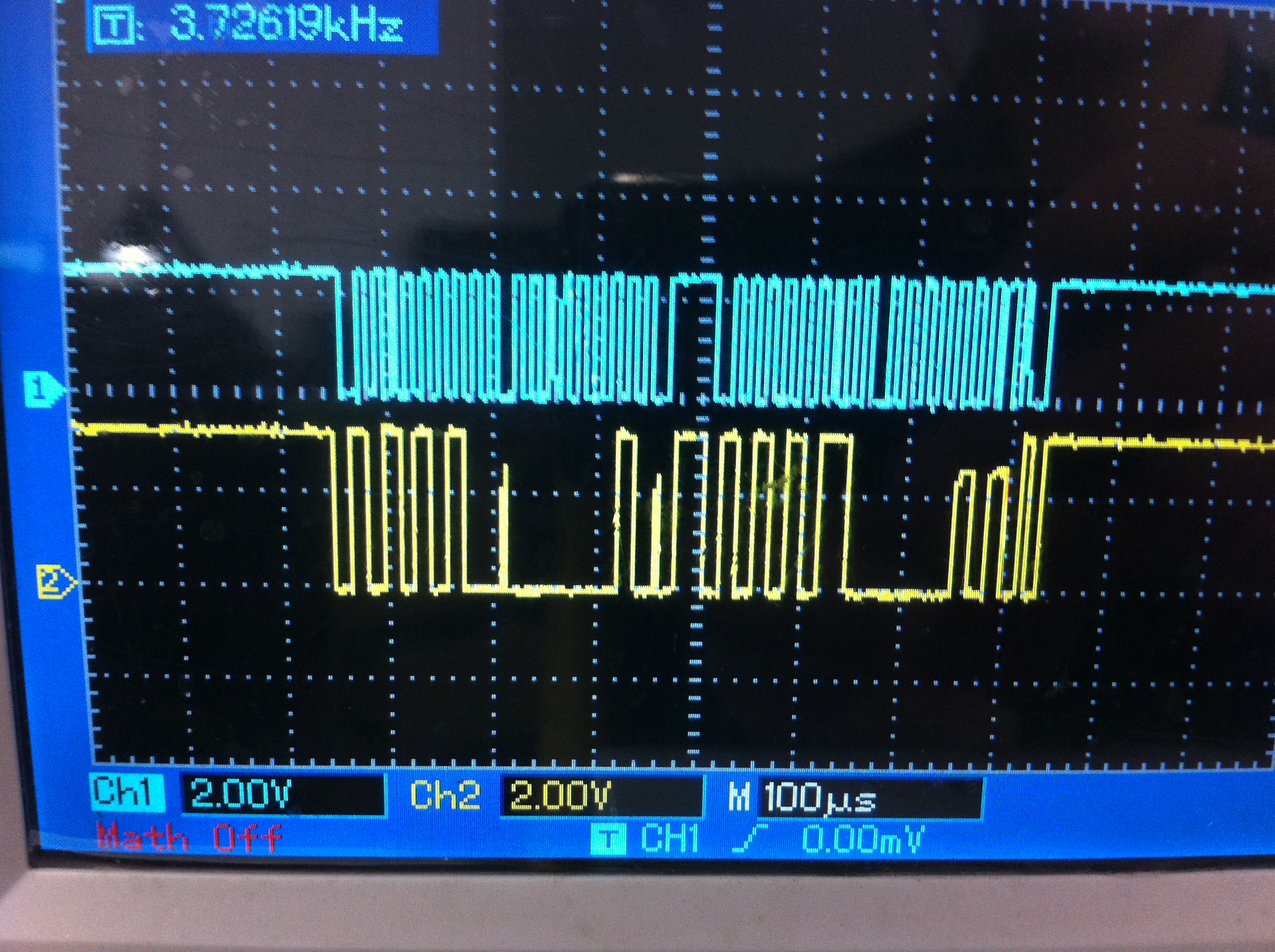

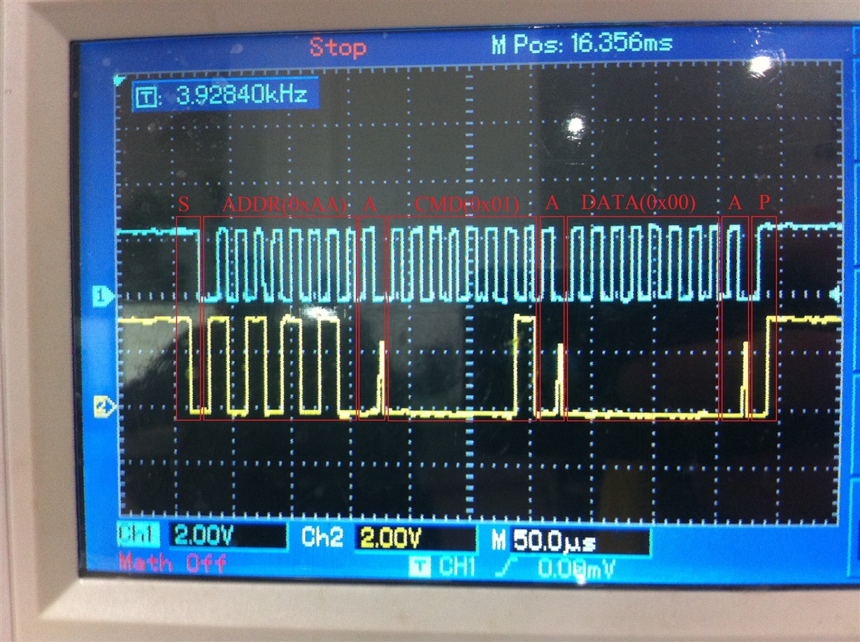

  • Tom,
    I can read data from the address of 0x7e / 0x7f, which is 0x00 / 0x01 . But I can't read the correct data form 0x00 / 0x01 after I write 0x00/0x08, the data always be 0x05, I use EV2300 to read it ,and it return 0x05 either .
    Why should keep SCL and SDA low for a while ,after send 0xAB,and also after read the first data?
  • The gauge will hold the clock low until it is ready to respond. I2C controllers are able to support clock stretching. This will lead to communications problems, if your controller cannot support it.
