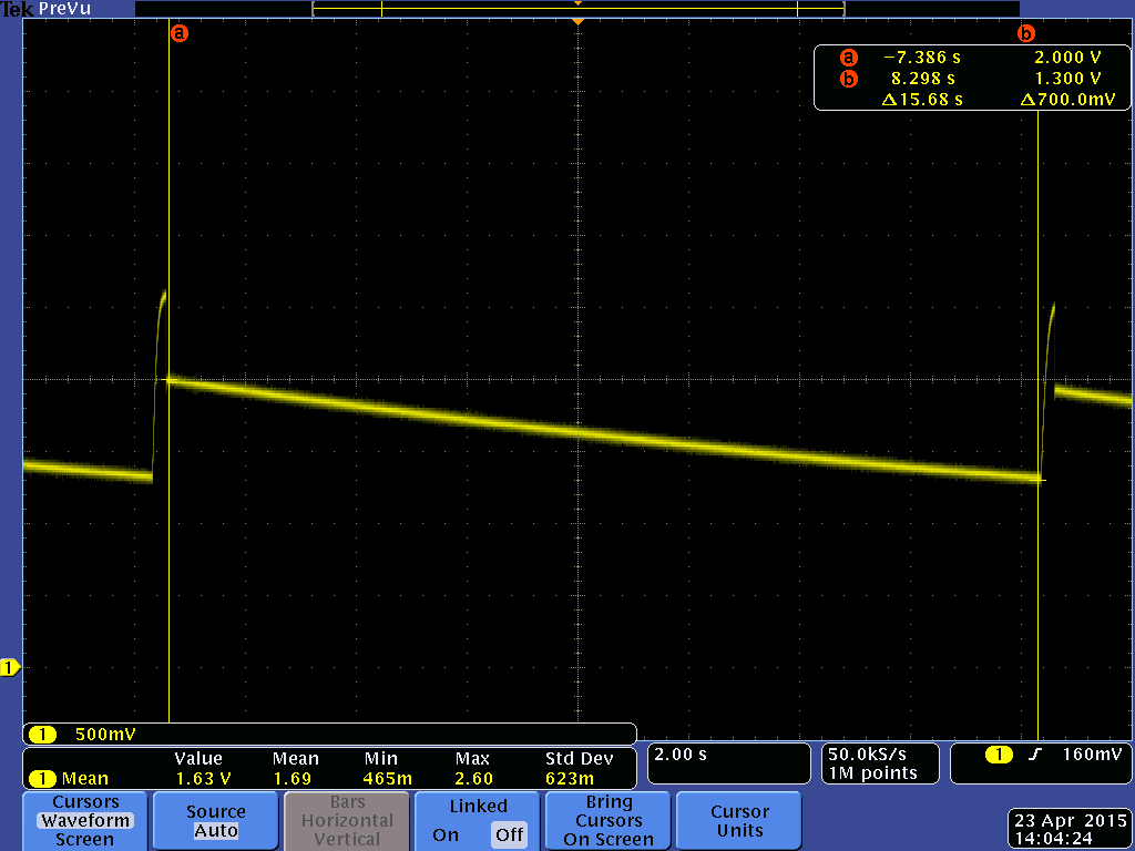

I noticed a strange behaviour when measuring the quiescent current of the prototype. I'm measuring a current of 335nA, but every 80 seconds the current rises to about 550nA and then slowly returns to 335nA. The EVB doesn't have this behaviour.
  • I have done some more measurements and have found a possible cause why the input voltage drops. The VREF_SAMP capacitor apparently discharges. Because I can't measure on this capacitor as this will discharge it, I have captured the input voltage which should follow the voltage on the VREF_SAMP capacitor.
    It discharges with 0,44nA (i=10*10^-9 * (0,7/15,68)=4,46*10^-10).
    The datasheet says the leakage current of this cap should be less than 2nA @ 3V. If I calculate this, the cap will discharge 3,2V at a rate of 2nA in 16 seconds (16*(2/10)=3,2V).
    I'm using the following capacitor: CC0603KRX7R9BB103. I also soldered this capacitor on the EVB where it functions without problems.

  • You need to select a low leakage capacitor. Typically, the higher voltage rating on the capacitor, the lower the leakage. Also, solder flux residue can create parasitic resistors in the 100k-1M range across components.
  • It turned out to be a problem with the cleaning of the PCB. We didn't clean the PCB thoroughly enough which created a leakage current (which Jeff F also mentions).
