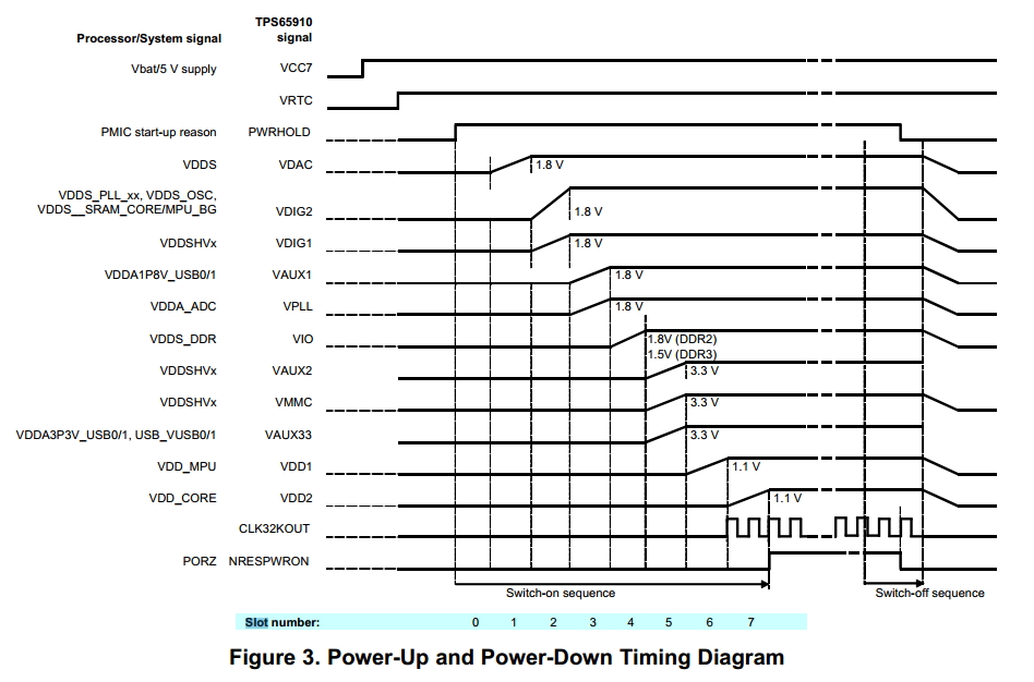

TPS659102 exchang slot number
Hi ,
          If connect BOOT0 to ground and BOOT1 to VRTC to select EEPROM boot mode.
       How to exchange slot number?
       Please help me to confirm, thank you.
  • Hi Mars,
    The boot sequence for the TPS659102 is pre-defined and cannot be modified. Each TPS65910x device has a specific boot sequence that is enabled by the boot pins. After the device is active you can adjust the regulator settings, but these settings will not be saved after the device is reset. What are you wanting to change?
