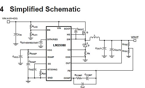

The PTN78020W (6A, Wide voltage input) datasheet doesn't specifically call it out, but I'd like to use this in an inverting application where I apply +12V and I get out -4.2V.  I'd like to get close to get 5+ amps out.  Is this configuration OK for this part?
