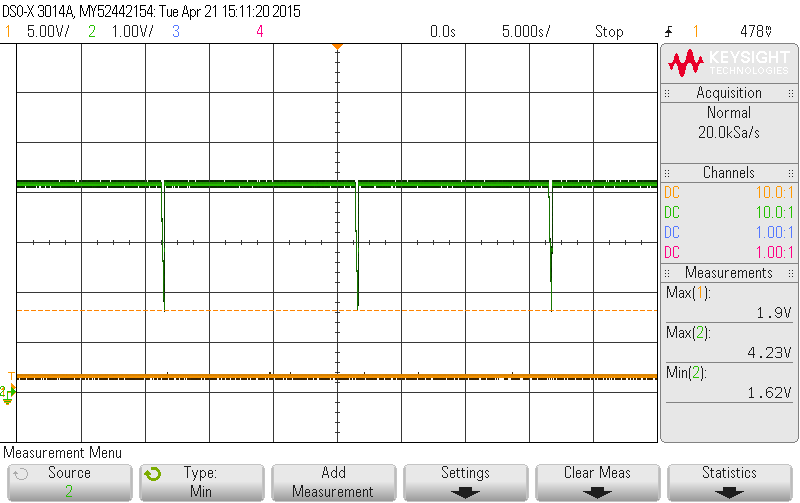

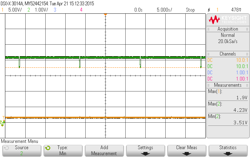

The next weird phenomenon is when we connect a voltage source at the VSTOR.
We connect this voltage source to simulate a battery.
When i put the voltage source on 0V. I understand why it goes to 4.2V (because of the installed resistors). But as you can see in the screenshot of my scope that there are some peak voltages (going to 1.6V) why are these peaks there?
when i increase the voltage of my voltage source ,connected on the VSTOR, the lowest point of the peak also increases.
I suppose that the use of the peaks are to measure the voltage. But i'm not sure of it. can anyone confirm my theory?
