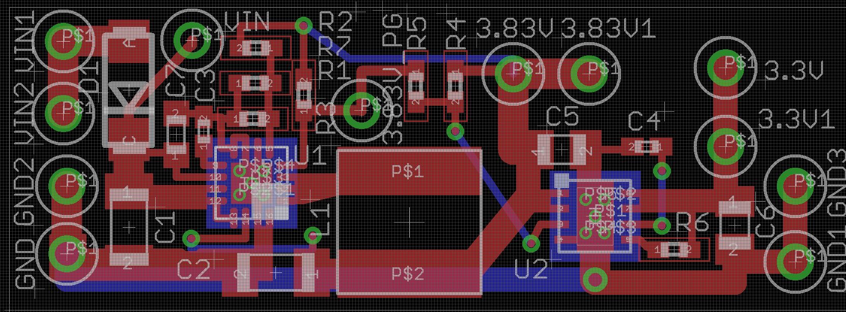

I am testing out the TLV62130 to potentially be used in our new product.
However, every time a short-circuit is produced across the TLV62130 output (i.e. not the MCP1727), the TLV62130 is damaged (the failure mode is typically either a very low voltage (~250mV, when set to 5V) or erratic output waveform).
There are expected small sparks when short circuiting the output, but I wouldn't imagine this to be the cause of the damage.
We had planned to use the TLV62130 along with a MCP1727 LDO, so I included both here for completeness.
We currently are using a 6 ohm dummy load on the output.
Is there any way to prevent the short-circuit damage?
Much appreciated!!!
Justin
  • We are going from ~14V to 5V on the TLV62130 (not 3.83V, as labeled on the schematic / layout test points).
  • Thanks for posting your schematic and layout. Do you have a waveform of Vin, Vout, SW, and inductor current when you apply the short and then again when it isn't working? What inductance do you use?

    I will try to put another IC on the board and get the data you request.  Do you have a recommended way to get the inductor current, given the schematic posted?
    We are using Bourns SRN6045-2R2Y - 2.2uH, 30%.
  • To measure the current in the inductor, you need to remove the inductor, solder one end of it to the SW pins, and put a wire in series with its other terminal and Vout. Clip a current probe around this wire.

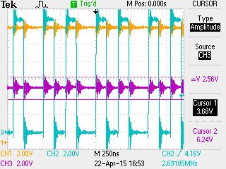

  • Does the waveform below look correct?  I finally have a TLV62130 on board that seemingly isn't blown, but not sure about the waveform.  Yellow is Vin (~13V), Blue is SW, Red is Vout.
  • The pulses on SW should be evenly spaced. I suggest adding another 22uF output cap to overcome the DC bias effect.
    I suspect you need a bigger inductor than2u2H and 6045 size as the inductor may well be saturating before the IC can current limit. Can you please advise the batch code line 2 underneath the part number, indicating the week number the device is manufactured?

    There seems to be a lot of noise on the input, SW and also Vout. Could you please share a picture of your bench setup?

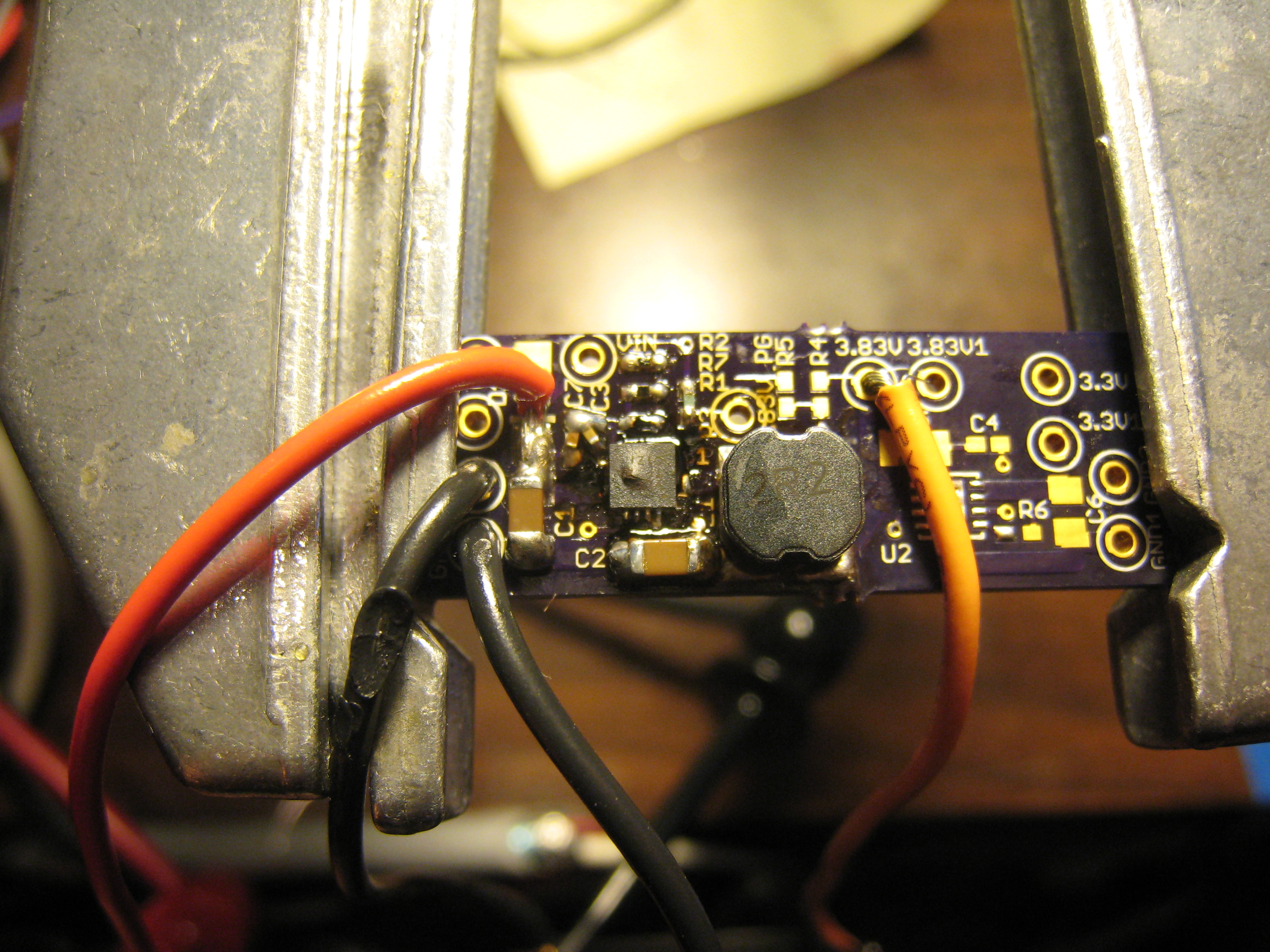

  • Hi Anton,
    Sorry for the late reply - I had to order more PCBs from continually replacing the TLV62130s until the pads gave out, then got busy with other stuff.
    I recently started testing again, trying to keep a better record of the configuration of each burned TLV62130.
    Three burned relatively quickly today (this a new lot of TLV62130s than before, FWIW).
    To create the short circuit, I have simply connected a cheap switch (i.e. likely bouncy) to the output and ground (it doesn't seem to matter whether a load is otherwise connected or not).  I open and close the switch repeatedly.  I can occasionally see spikes (which I assume is from the inductor) on the output when I open and close the switch, but nothing higher than 15V that I can capture.  After several iterations of shorting the output, I will get a burned TLV62130.  The failure mode is short to ground.  If I don't quickly turn off the power supply, it will put out its max 5A and the TLV62130 will sometimes start smoking (see picture below).
    The input voltage is 14V.  I even connected a low ESR 100uF electrolytic in parallel with the 10uF ceramic cap (not shown in the pic), but it didn't seem to make any difference in the IC being destroyed.
    I am using a standard lab power supply with 18" leads.  This is a lot better configuration than our product will have in the field, so please let me know if the TLV62130 can't handle much input inductance.
    I would really like to use this part, as it has the form factor, switching frequency, efficiency, etc. I need.  But unless someone can provide an answer as to why it keeps burning, it would be poor judgement to go with this part.
    I look forward to your (or any TI representative's) response.
    Thanks!
    Justin

    I'll need to see some waveforms to fully understand what is going on. The waveform I need ideally is when the converter breaks. Could you probe Vin, Vout, SW, and the inductor current at maybe 20usec/div? Trigger on Vout falling to see the moment when it breaks.

  • Thanks for sharing the details on the other thread. It was unclear to me that the above circuit was being damaged with a DC load applied.
    I would expect damage to it when powered from a car battery due to the voltage spikes. A TVS may help but its clamping voltage and power would need to be checked.
    If you are applying the output shorts in the above picture through the yellow and black wires, this inductance is likely causing voltage excursions on Vout outside of the IC's ratings. You could measure the voltage across C2 and see if it ever goes below ground or above 7V. These inductive shorts are typically lab setup related as the load is located on the same PCB as the power supply in most cases (and therefore has much less inductance in its path).
    If you are still having random issues with a DC load, then I could evaluate a picture of this setup as well as your operating conditions (Vin, ambient temp, anything special in your setup) to debug. As well, could you send the part numbers of C1 and C2 which you have been using (I assume these have not changed?)?

    Yes, the yellow (orange) wire was used to connect to ground via a switch in order to short-circuit the output. The wire was a few inches (<6") long. Correct me if I'm wrong please, but you're suggesting that the impedance from a wire of this length could cause a voltage excursion outside what the TLV62130 can handle in a short circuit event, which may lead to the 'burn' failure we see, correct? If this is the case, this definitely isn't the regulator for us, as our product has sensors connected to it (GPS receiver, for example) that have wire connections several feet in length. I will investigate the Vout excursion with these inductive shorts, as you suggest, thank you.

  • No, the capacitors didn't change. C1 = Taiyo Yuden TMK316BJ106KLHT; C2 = Murata GRM21BR61A226ME51L. The setup is in open air, room temperature.
  • Thanks again for clarifying and continuing to dialogue on this issue.
    The issue with inductance in the output leads is the ringing created. Instead of just Vout and GND, now you have an LC circuit which can ring up and down--above 5V and below GND. For the TLV62130 and for most ICs, the absolute maximum ratings in the data sheet prohibit most pins from being taken a diode drop below GND. The ringing from the cables could cause this to happen. It's worth checking on your board. Are the wires a twisted pair?
    It's interesting that in the one failure you noted, the IC still switches. When it spontaneously dies, does it always fail this way? Did/could you Ohm out the SW pin to GND and measure things like FB, SS/TR, SW in operation (when it's not working right)?

    Did you try adding another 22uF output cap next to C2? The SW node waveform you shared earlier showed an irregular spacing. This can be caused by not enough output cap, which is likely since the 5V output voltage creates quite a bit of DC bias loss.

  • Larger value ceramic capacitors like these have a 'DC bias effect' whereby the actual effective capacitance in the circuit decreases as the DC voltage applied on them increases. This is shown in each of the data sheets for the caps you are using. 5V is a rather high voltage and so yields significant loss of effective capacitance. This is one possible cause of the SW waveform you showed earlier. I recommend adding 1 more 22uF at the output and seeing if the SW node becomes more regular.
  • I added the same 22uF ceramic cap to the output. but the SW waveform didn't change at all.  I even added a 100uF alum electrolytic for fun with the same results.
    One note - the regulator is being significantly underutilized at the moment - only pulling about 200mA at 12V.  Not sure if this makes any difference in terms of the "spontaneous death" failures.  If I remember correctly, we used a heavier load in our short-circuit testing , and it always had uneven SW spacing.
