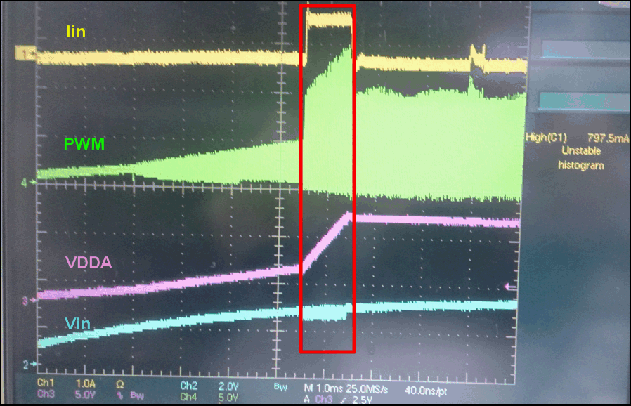

I have three question as below.
1.In soft start period why have 1A Iin inrush current.?
2.Is 1A  fix? or can follow why condition to reduce?
3.How i  can to reduce Ilin on soft start period?
Test condition as below
Vin :3.3V Iout: no load
Measure result as below
CH1:Ilin
Ch2:Vin
CH3:VS(Boost output)
CH4:SW

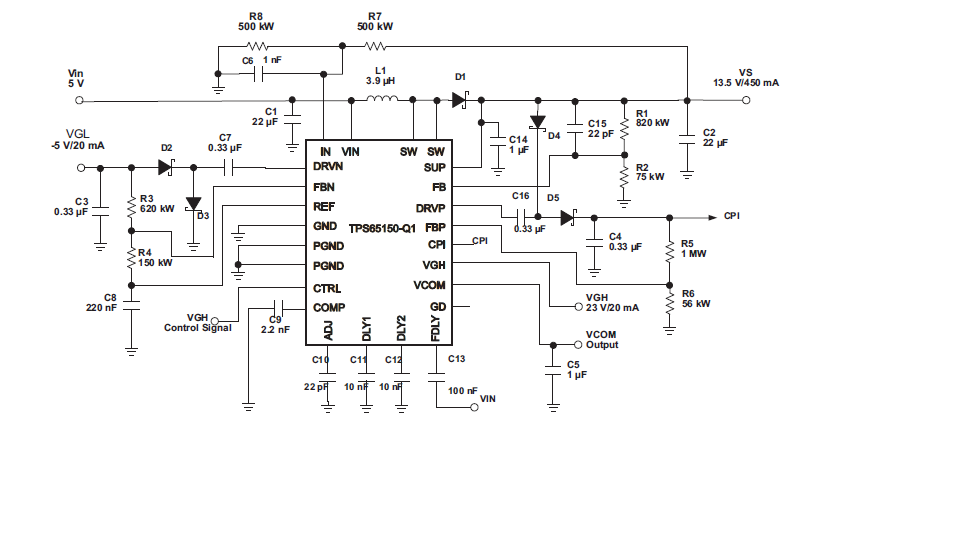

Schematic as below

  • Hi Jericho,
    Thanks for your question.
    1.) During start-up the boost converter follows an internal ramp in three steps. 1st step current limit is set to 2/5 of the current limit, then 3/5 and the 3rd step is the full current limit. 1A is the current limit here, see 2.)
    2.) 1A is the maximum P-MOSFET peak switch current
    3.) I will have to check this, whether you can reduce the Ilin on start-up
