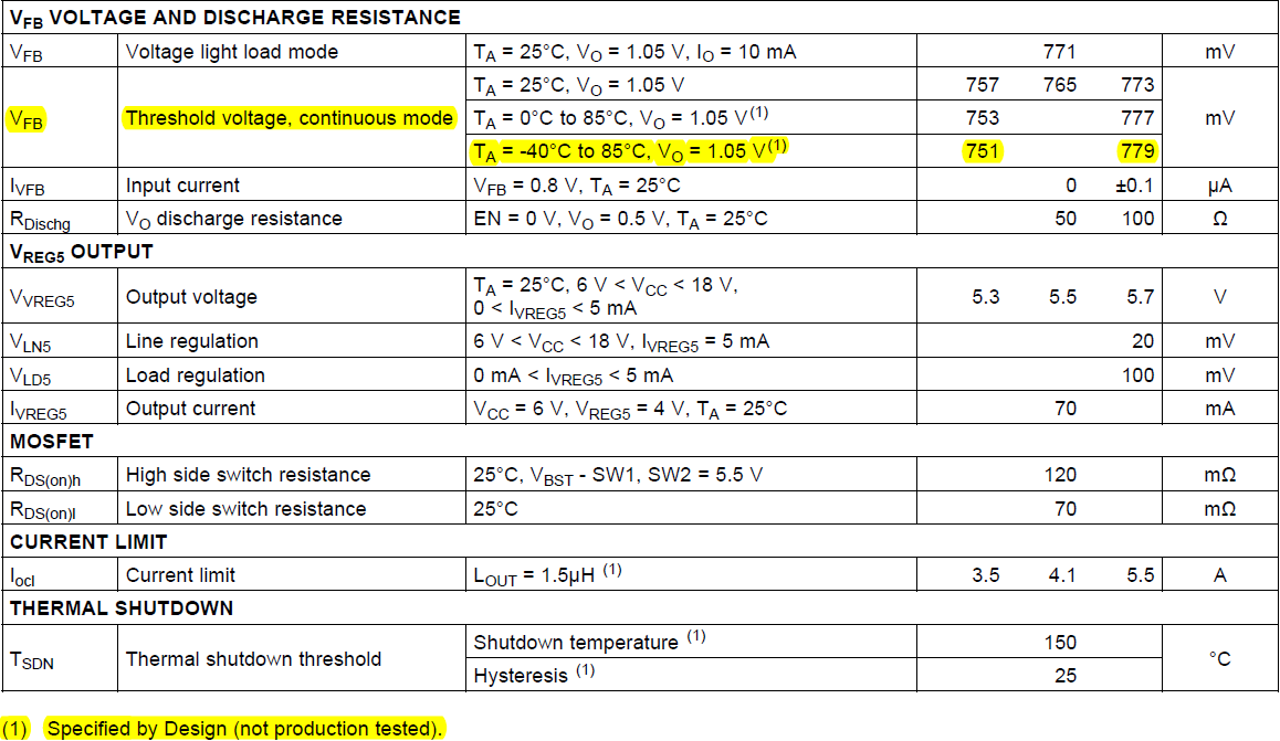

Our customer are going to use TPS54226 or TPS54326 at the following conditions.
Vout=1.1V @ Vin=7.6V , Iout=700mA
Vout=1.4V @ Vin=7.6V , Iout=200mA
They would like to know the actual value of VFB at TA = -40°C to 85°C to estimate the variation in output voltage closely.
I’m understanding that this spec is not production tested.
However, Could you please let us know if you have any data?
