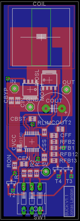

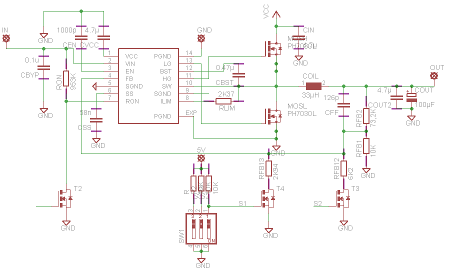

I have made a Buck convertor based on the LM3150. It works exactly as expectd untill it reaches an output power around 15W, than the controller just burns, some smoke apears and it smells bad. I have been searching online if there is some kind of power limit on 15W, but didn't find anything. The convertor should be able to deliver upto 12Amps, so 15W is not a lot.
The output voltage can vary between 5,12 and 20V by changing a switch which enables extra feedback resistors.
Here are my schematic and PCB:
