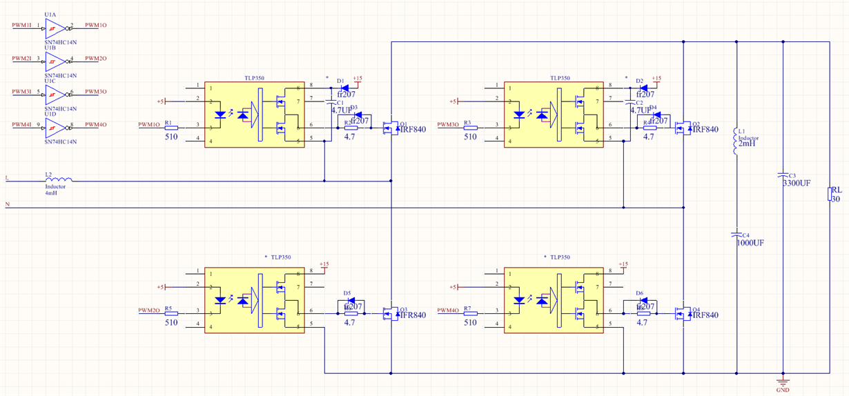

about single-phase PWM Rectifier
Will someone uses a single-phase PWM Rectifier TMS320F28XX done it? I will open loop SPWM added to the four mosFET, but the input current is the same as the diode is a pulse waveform, and the first 1/4 mos very hot, I ask what it might be?
