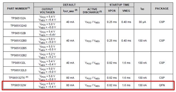

 In datasheet, TPS65132W default Iout_max(Ineg) is 80mA. This device can change Iout_max capability at APPS bit.
  APPS bit is 0: Smartphone mode(Ineg_max=40mA)
  APPS bit is 1: Tablet mode(Ineg_max=80mA)
 What is TPS65132W default APPS bit?
