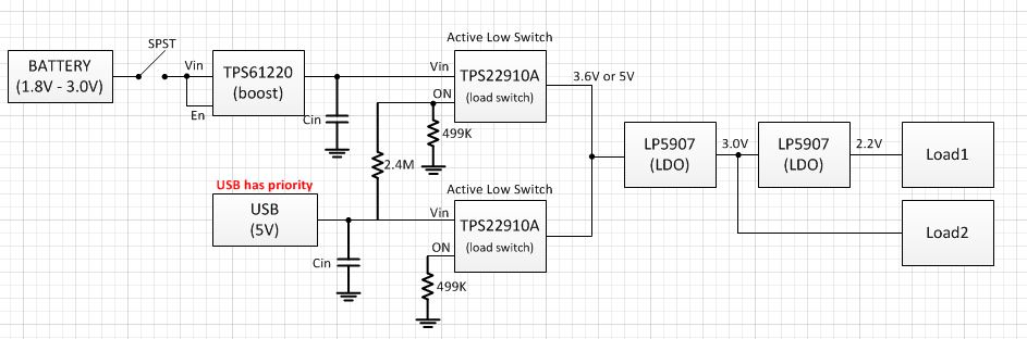

    The diagram below shows what I was thinking about. The power multiplexing circuit is nice so that if both supplies are plugged in, only the USB gets priority.

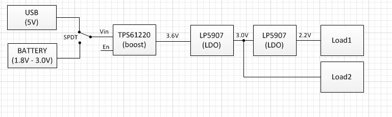

    This was my initial thought without the power multiplexer scheme, but how would I control the EN of the boost in a low power way so that when the USB is plugged it, it goes low, and when the battery is plugged in, it goes high.

  • Also what are some of the advantages/disadvantages of using a buck/boost compared to just a regular boost with the configurations above?
  • You can move this internal if you need to.
    A buck-boost would be 1 IC required to get your 3V from both inputs. The batteries could be diode OR'd with the USB port to make a Vin to the buck-boost. Then, a stepdown is needed to get 2.2V.
    You might consider running everything at a common voltage--3V or 2.7V. This would reduce the number of regulators and thus cost.
    I'm not sure what is special about that LDO. A buck converter would be far more efficient. TPS62740 is a great one to use. Here's a blog (which refers to a paper) where I describe it in a thermostat: e2e.ti.com/.../smart-thermostats-connect-to-the-iot-enabled-by-power-management
    I think you should keep TPS61291 and connect it directly to your batteries. Control its enable from the MSP430. Boost to 3V. Connect your USB port through an LDO to the same 3V net. A voltage divider from the USB 5V to the MSP430 would allow it to detect if a USB voltage is present. If it is, then turn off the boost. Or you could use an architecture like what you have drawn where the power sources are combined at the beginning and an LDO needed afterwards. This would be less efficient when running on batteries. In either configuration, you will need to figure out how to prevent current from the USB port from flowing into the batteries. The TPS61220 might work for this, those load switches, or some reverse polarity FETs/diodes to prevent backwards battery insertion.
    Then, from your 3V rail, you use TPS62740 to get 2.2V.

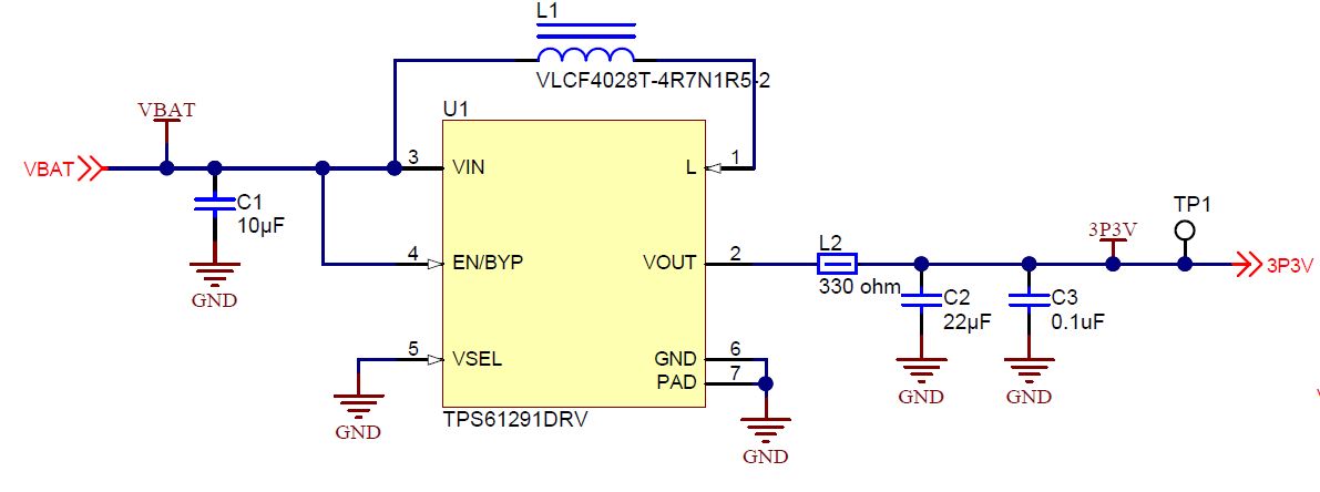

    So I decided to go with the tPS61291. I was running some webench sims with different load conditions. Most of the inductor selections come up with a 3.9uH. The datasheet has 3.3uH. I designed a board with a 4.7uH to try and cut down the voltage ripple more, but it seems like it may be instable. I am looking at my output on my board and it shows ~4.25V as the output. I have an input of ~2.1V and set the boost to be fixed at 3.3V.
    Can you confirm what the issue is?
    -David
  • You need to place the ferrite bead after the output caps.
  • Could you explain what the effect is? Since the L is right off of the VOUT, is that effect LC low pass filter somehow affecting the output?

    for a boost converter, the output capacitor must be placed directly with VOUT pin and GND pin because the current flowing though the VOUT pin changes in step.
