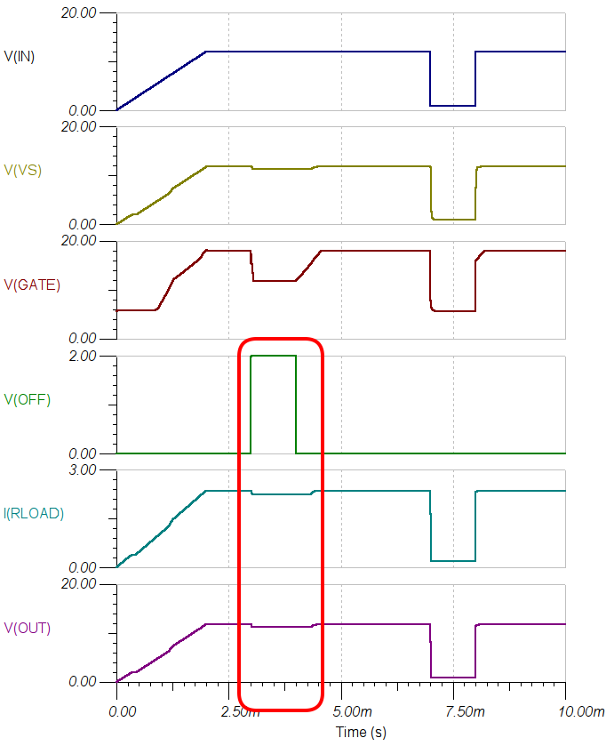

Is it possible that TINA transient models snmv061 (LM5050-1) and snmv063 (LM5050-2) have problems with simulate Voff condition? Here is what I got when start mentioned transient analysis for mentioned models:

    That is possible, Please allow more time for the OFF condition and have the load at the out to discharge the output cap. Please note when you turn of the MOSFET buy OFF Pin (Pulling the Vgate low ), the MOSFET's, the power flows thru the body diode of the FET.
    Dinesh
  • There is no output capacitor. Anyway what is a right way to deploy OFF pin? It's stated that A logic high state at the OFF pin will pull the GATE pin low and turn off the external MOSFET. I forgot how mosfet is wired here and that body diode can conduct. In this case it seems that purpose of OFF pin is not to isolate power source from the load. Sorry, I just trying to figure out to what extent LM5050 is suitable for my project (I have possibility to switch off PSU's outputs before ORing).
  • The gate turn off pin could only be useful if two FETs and two LM5050-1 were used as a solid state relay, if that is even possible. I have not tried. Otherwise the turn off feature is pretty useless as the intrinsic diode will take over conduction and defeat the purpose of the chip, to eliminate the losses of this diode. Perhaps useful if you needed some heat generation;-)
