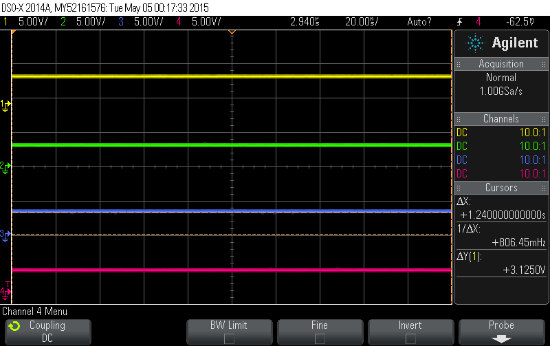

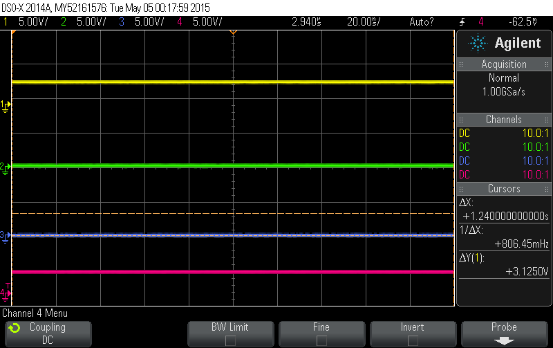

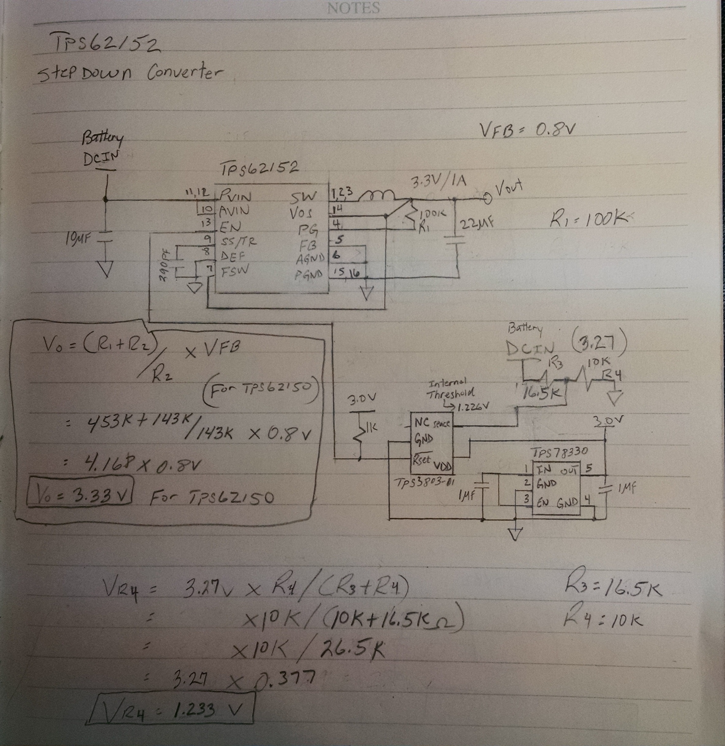

    I am using a 3V regulator to power up the TPS3803. I have a voltage divider on the sense pin that drops reset low when the voltage threshold level is reached. The TPS3803's output is connected to a pull up resister to 3V and that output is going to the enable pin. I do not have a pull up resister on Vin. PVin; AVin and EN are connected directly to my source. Please find attached the pictures of Vin; EN; Vout of the TPS62152 and VDD and Vout of the TpS3803-01. and also the schematic. Trace 1 is TPS62152 PVin/AVin, Trace 2 is Vout, Trace 3 EN and trace 4 is VDD of the TPS3803-01. I am a little hesitant to connect this detector to the enable pin because I already damaged 3 devices. I will try one more time and get those waveforms for you however; if it still doesn't work for me I will use a load switch and let the detector gate it and EN will see the same source as PVin and AVin then when the threshold is reached and reset goes low the load switch will be disabled. I soldered the leads directly to the device per data sheet.Thanks Chris I'll keep you posted.
    Jeff
  • I'm not understanding how PVIN/AVIN/EN are all connected together and then you connect just EN to the output of the SVS (instead of having it connect to PVIN/AVIN). Do you have a jumper or something on your board or are you modifying the PCB with a cut, etc.? Perhaps posting a partial schematic will help.

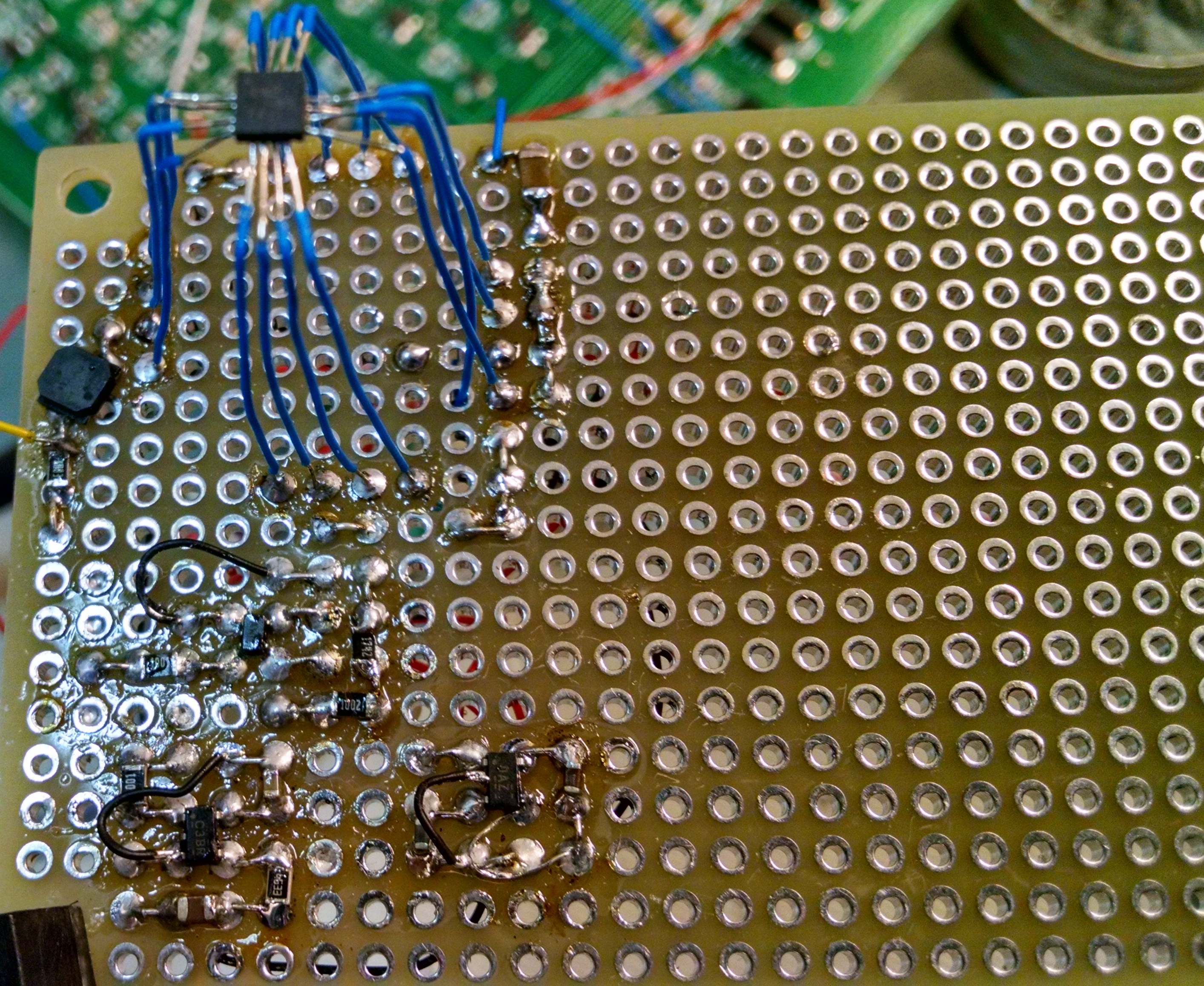

  • Chris, I do not have an Evaluation board, I have the QFN chip and just soldered directly to them and soldered the leads to my prototype board. Thanks.

  • I'm still not perfectly clear. Could you post the prototype layout you are testing on?

  • Oh, this is your PCB. This will not work for a switching power supply. There is way too much inductance from those wires and connections to get reliable operation.
    There may be something else with your SVS affecting things, but you need to order an EVM and test the SMPS on a known good layout. The above may work for some linear circuits (LDOs, SVS, etc.) but not a switching circuit.
  • OK got it, I'll get an EVM board. Thanks Chris.
