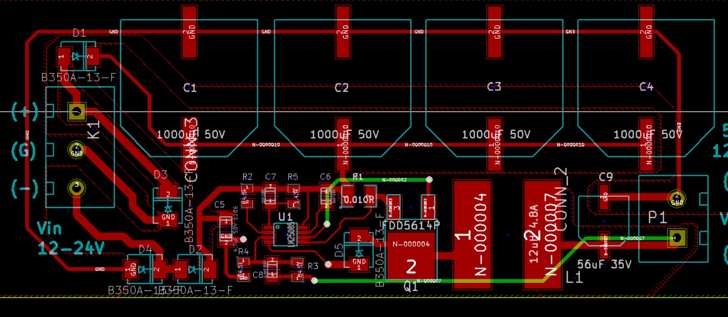

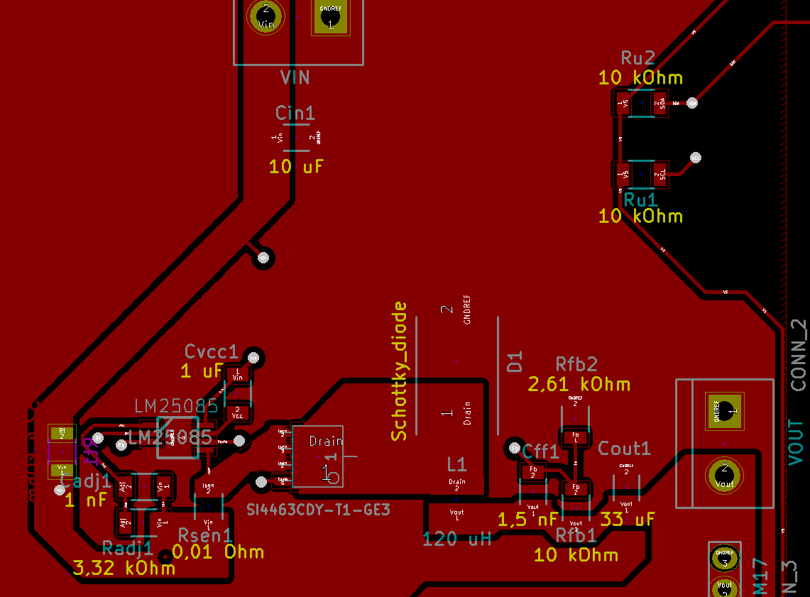

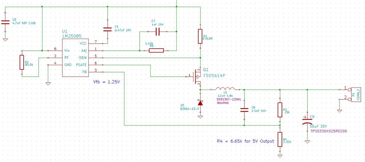

I'm trying to build a buck DC-DC converter, using the LM25085, based on Webench design.
Input range is 14-24V, required output is 12V @ 3A max current.
The circuit seems to be working without load, but when I load it, the output voltage drops to much lower values - depends on load and input voltage.
I'm using the recommended components for all critical components. (I think)
What could be the problem ? (I already assembled 2 PCB's, and getting the same results, so I assume it's not bad assembly or defected chip)
Thank you.
