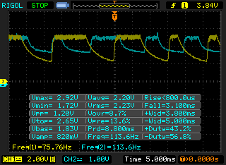

Yesterday I launched my Power supply for FPGA and unfortunately all 3 outputs were unstable.
This is my first experience with DC-DC converter and I have no idea what to do, what may be wrong?
If you have any suggestion I would be glad to hear it.
Here you have my shcematic (it's typical schematic from datasheet, only resistors to set the proper output voltage were changed )

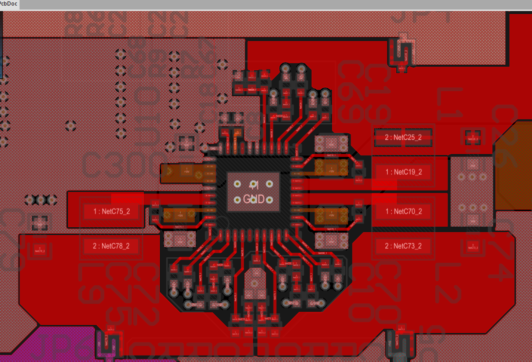

PCB layout also was rewritten from datasheet
And this is how my output of 2,5V and 5V looks like:
I will accept any help :)

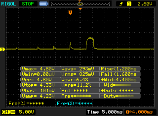

  • Thanks for answer, but after some measurements something has changed, first in 5V output than after some time in 2,5V output.
    Output is dead until turning off the converter - while turning off then output looks like this (5V) just before complete shut down.

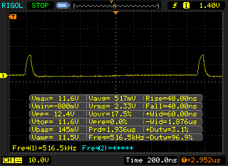

    While power is turned on voltage on LX3 pin looks like this:
    Frequency looks almost like the switching frequency (508Khz calculated for my resistor) but why 11,6V?
    This repeats all time, I zoomed to better see the shape.
    About the current:
    To 5V output I connected red led + 330ohm resistor so I may "see" this ripples (previously) and the pick when turning of the device. To 2,5V I also connected led but with smaller resistor about 60-70 ohm.
  • That is how a switching converter works. You should see a pulse train at the SW node at your operating frequency. The pulse amplitude will be just about Vin. The average value = Vout. From your previous waveforms, it looks like teh device is shuttting down and re-starting. It could be hiccup current limit. if the OC last mor than 10 msec, it can shut down all three converters.
  • Yes, it looks like you are right, it is hiccup effect. But how can I reach current limit with just led + small resistor at output?
    R47 sets current limit to 3A.
