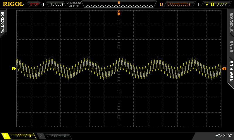

SYMPTOM 2: Small oscillation after high-slew current steps
I don’t know if this is related, but I have noticed that after large, high-slew current steps of (roughly) at least 5A magnitude and 1A/us slew rate, a small oscillation appears.  On the output, this is only about 100mV peak-to-peak.  The frequency is about 45kHz, which is near the crossover frequency of my loop transfer function.  I’ve done a lot of tweaking of the compensation network to try and fix this, increasing the phase margin and decreasing the crossover frequency, but with no visible change in behavior.  Otherwise, transient response appears to be fine.

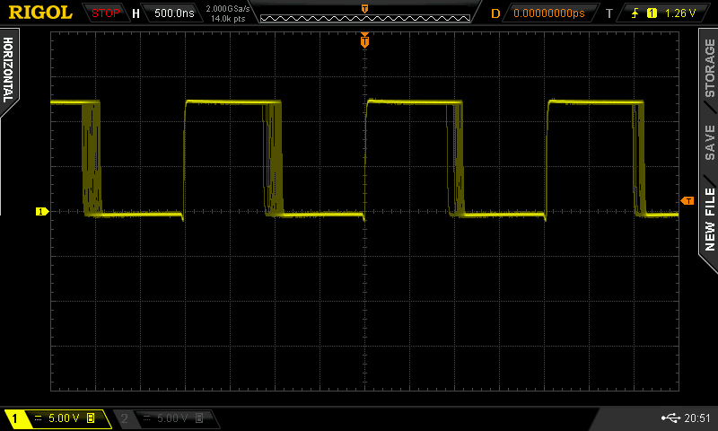

Schematic:

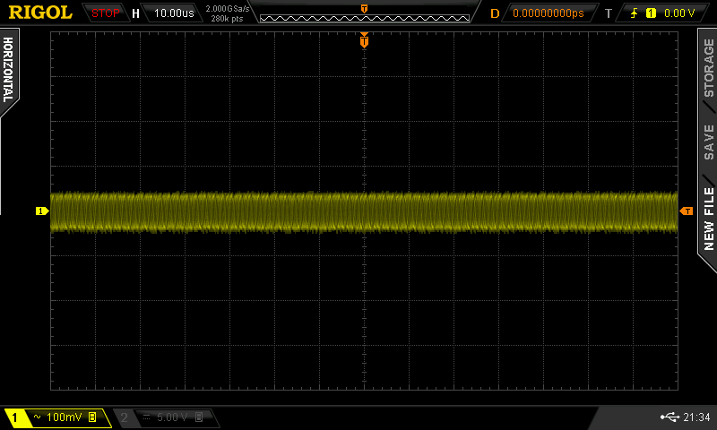

Normal, Un-triggered Output:
Output with 45kHz oscillation:
Duty-cycle variation as a result of 45kHz oscillations:
