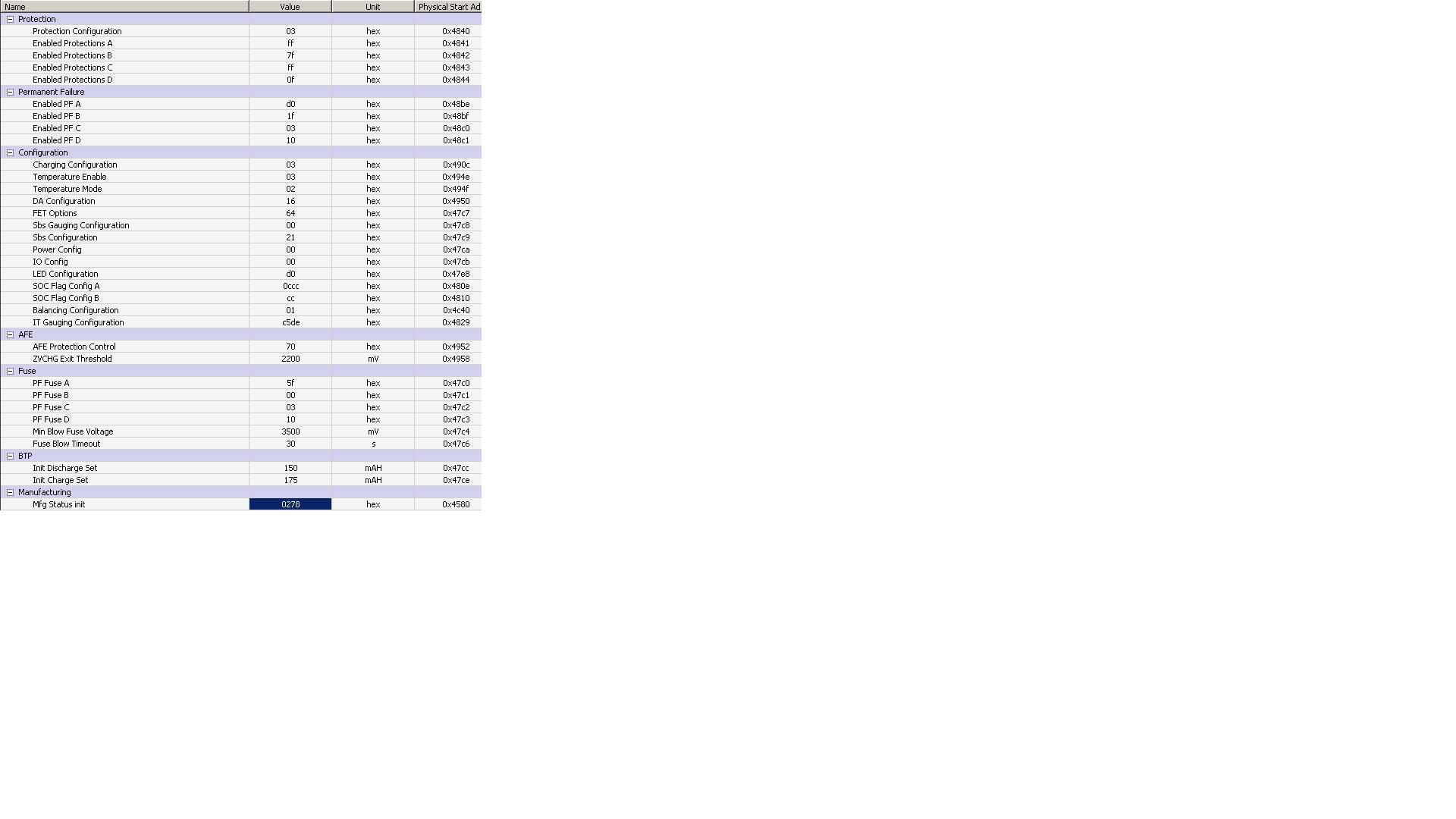

    and measure value of voltage at pin CHG on board bq40z50emv. For all combination of bits I see for charge 23V and 6V for lose charge.
    ps: I try switch on/off bit CHGFET - no success
    For example my current setting:
