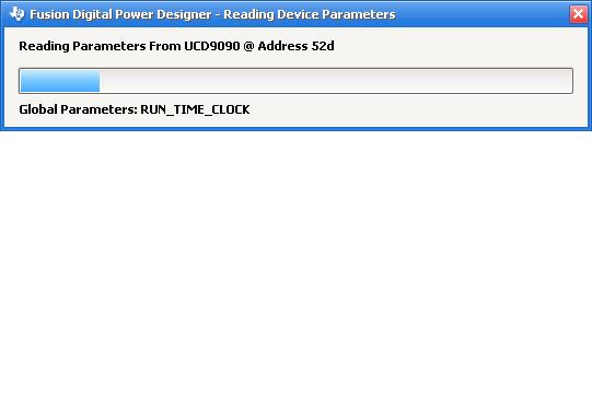

We are using a UCD9090 sequencer where the UCD9090 monitors a few voltage rails and general purpose inputs and activates a few general purpose outputs based on the inputs and monitored voltages. On one board occasionally the UCD9090 does not activate any outputs even though all inputs are at valid levels. I connected this board to a USB interface adapter and attempted to use the Fusion Design tool to see what was going on with the UCD9090. When the USB interface adapter is connected, the UCD9090 will never activate outputs. The part is somewhat functioning. The Monitor in the Fusion Design GUI does show valid values for the inputs, so I2C is working and the part is correctly reading the voltage rails being monitored. Also, there is a window that continually pops up in Fusion Design that says Reading Device Parameters. This does not happen if the UCD9090 is functioning correctly. We have observed this behavior on only one of a few prototype boards. Any ideas what might be causing this situation?

    Please also provide a screenshot of the pop-up window.

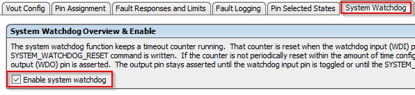

  • I see a System Watchdog Timeout fault. The System Watchdog does not have I/O pins assigned to it. If you did not configure it on purpose, you can disable the watchdog and see if the problem is solved.
    Zhiyuan
  • The watchdog was enabled intentionally and configured correctly. I disabled watch dog, but this did not fix the problem. Apparenly I forgot to re-assign the IO pins when I re-enabled the watchdog.

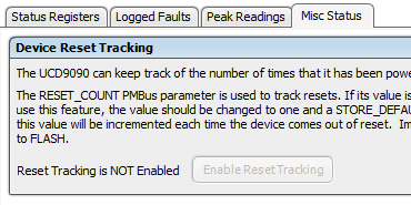

    Also, please enable Reset Tracking function.
    After enable reset tracking, please also clear all faults and logged faults, and run the device for a while, and then check how many times did the device reset. Please save a project file and send to me.

    I then power cycled the board with the FUSION tools attached.  The UCD stopped functioning.  I verified that the watchdog and run time clock were disabled.  There is a watchdog error in the logged faults even though the watchdog is disabled.  I then enabled reset tracking.  The UCD9090 is continually being reset.  I then saved the project file.  The project file is attached.  I opened the project file in the FUSION offline tool and noticed that only 2 of 5 run time check boxes were de-selected even though all 5 were deselected when connected online.

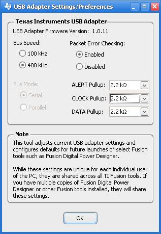

  • What are the voltage and current measured on the PMBus Clk and data? What are the USB Adapter setting (you can find the info using Fusion GUI->File menu -> USB Adapter Setting)?
  • The I2C signals are pulled to 3.3V with 4.7K resistors.  I changed to 1.2K pull-ups, but the results are the same.  The I2C communication is successful when the UCD9090 is in the state where it continually resets.  The USB adapter setting are attached.
